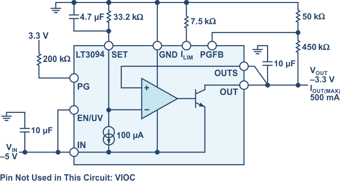

-3.3 V output low noise solution.
Figure 1. –3.3 V output low noise solution.
The LT3094 features a precision current source reference followed by a high performance output buffer. The negative output voltage is set with a –100 µA precision current source flowing through a single resistor. This current-reference based architecture offers a wide output voltage range (0 V to –19.5 V) and provides virtually constant output noise, PSRR, and load regulation independent of the programmed output voltage. Figure 1 shows a typical application and the demonstration board is shown in Figure 2. The overall solution size is only about 10 mm × 10 mm.

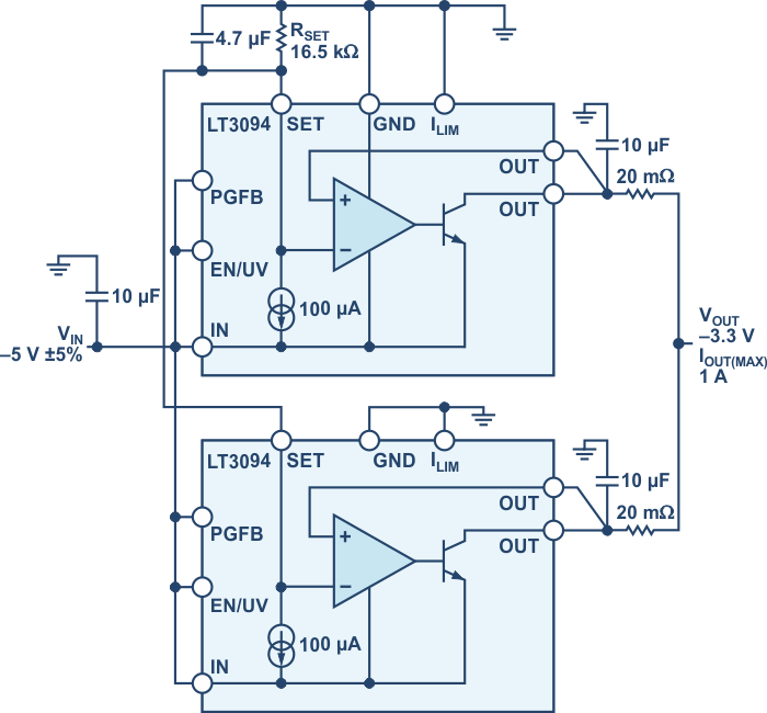

The LT3094 can be easily paralleled to increase output current. Figure 3 shows a solution using two LT3094s paralleled to achieve 1 A output current. To parallel two devices, the SET pins are tied together, and one SET resistor, RSET, is placed between SET pin and ground. The current flowing though RSET, is 200 µA, twice the amount of the SET current in one device. For good current sharing, a small 20 mΩ ballast resistor is used at each output of the LT3094.
Schematic of two paralleled LT3094s.
Figure 3. Schematic of two paralleled LT3094s.
Figure 4 shows the thermal performance of the circuit in Figure 3 with –5 V input voltage and –3.3 V output voltage running at 1 A load current. The temperature of each part rises to about 50 °C, indicating the heat is distributed equally. There is no limit on the number of devices that can be paralleled for even high output current and low output noise.

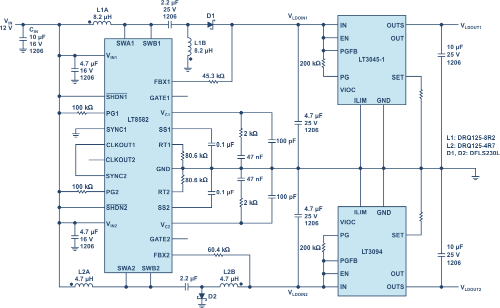

A power supply is generally built with a switching converter post-regulated by an LDO regulator to achieve low output noise and high system efficiency. The optimized voltage difference between the LDO regulators input and output is about –1 V in order to maintain a good trade-off between power dissipation and PSRR. Maintaining this voltage difference is complicated in a variable output voltage system, but the LT3094 includes a tracking feature, VIOC, which keeps the voltage across the LDO regulator constant even as the output voltage varies.
Adjustable dual output, positive/negative power supply features high ripple rejection and cool operation.
Figure 5. Adjustable dual output, positive/negative power supply features high ripple rejection and cool operation.
Figure 5 is the schematic of a dual power supply using LT8582, LT3045-1, and LT3094. The LT8582 is a dual channel PWM dc-to-dc converter with internal switches that can generate both positive and negative outputs from a single input. The first channel of LT8582 is configured as a SEPIC to generate a positive output, and the second channel is an inverting converter to generate the negative rail. In the negative rail, the voltage across the LT3094 is controlled by VIOC voltage as

where VFBX2 is 0 mV and IFBX is 83.3 µA. Setting R2 to 14.7 kΩ sets the VIOC voltage at 1.23 V over the variable output voltage. The resistor R1, at 133 kΩ, limits the input voltage of LT3094 to 16.5 V, calculated by

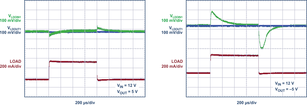

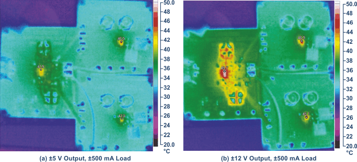

The thermal images of the circuit running at 12 V input are shown in Figure 6. When output voltage changes from ±3.3 V to ±12 V, the temperature rise of the LT3094 remains constant. Table 2 lists the voltage and current of all three devices. Figure 7 shows the transient response of the ±5 V power supply running at 12 V input.
Thermal image of a dual power supply at 12 V input.
Figure 6. Thermal image of a dual power supply at 12 V input.
In Figure 5, no additional capacitor other than the output capacitors at LT8582 is placed at the input of the LT3094. Generally, an input capacitor reduces the output ripple, but this is not the case for the LT3094. If the LT3094 has input capacitors, the switching currents from the switching converter will flow through the input capacitor, causing the electromagnetic coupling from the switching converter to the LT3094’s output. The output noise will be increased, degrading the PSRR. Provided that the switching regulator is placed within two inches of the LT3094, we recommend not placing a capacitor at LT3094’s input to achieve best PSRR performance.
Transient response of dual power supply at 12 V input, ±5 V output.
Figure 7. Transient response of dual power supply at 12 V input, ±5 V output.
