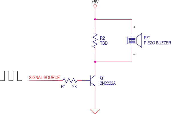

The simplest piezo drive circuit consists of a transducer and a switching transistor (Figure 1). The voltage across the transducer cannot be greater than the supply voltage, which places an upper limit on the acoustic output. The resistor R2 serves to discharge the capacitance of the transducer. The RC time constant should be short relative to the period of the resonant frequency of the transducer. Low resistor values decrease electrical efficiency while damping the mechanical (acoustical) resonance of the transducer, which of course reduces the acoustic efficiency.
While this piezo drive circuit is simple, it is very inefficient.
Figure 1. While this piezo drive circuit is simple, it is very inefficient.
