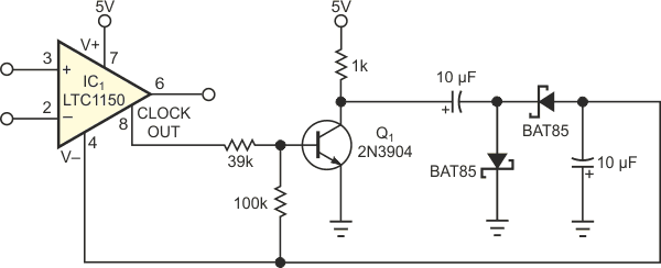

Many single-supply-powered applications require amplifier-output swings within 1 mV – or even submillivolts – of ground. Amplifier-output-saturation limitations normally preclude such operation.
This configuration uses bootstrapping to allow a single-rail op amp to operate at 0 V output.
Figure 1. This configuration uses bootstrapping to allow a single-rail op amp to operate at 0 V output.
Figure 1's power-supply bootstrapping scheme achieves the desired characteristics with minimal parts count. IC1, a chopper-stabilized amplifier, features a clock output. This output switches Q1, providing drive to the diode-capacitor charge pump. The charge pump's output feeds IC1's V– terminal, pulling it below 0 V, thus permitting an output swing to and below ground.

In Figure 2, the amplifier's V– pin (Trace B) initially rises at supply turn-on but heads negative when amplifier clocking commences at approximately midscreen. The circuit provides a simple way to obtain output swing to 0 V, allowing a true "live-at-zero" output.
