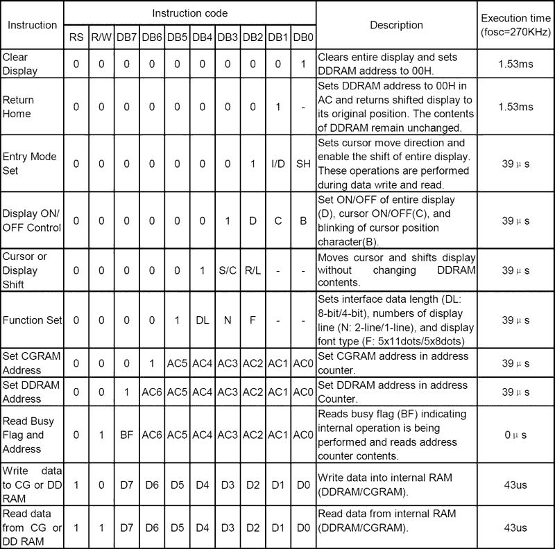

Instructions and Characters
The tables below show the instruction set and character table. Click on a table to get a larger view.
Click to enlarge
Click to enlarge
