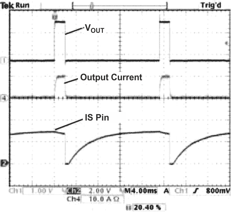

When the current-sense pin drops 50 mV below the input, the regulator turns the output off. This action then causes the current to go to zero, creating a high condition on the output of the comparator. The comparator has an open collector; therefore, the IS pin charges at the RC charge rate of R6 and C3. The output of the regulator remains off, drawing no current, until the IS pin charges to 50 mV below VIN. At this point, the output turns on. R5 and C2 provide a delay before re-engaging the current limit. This delay prevents the current required for charging the output capacitors from prematurely tripping the current limit. It also gives the circuit time to stabilize and to determine whether it can deliver the output current that the load demands. If the load is still too heavy, the current limit re-engages.
The circuit in Figure 1 cycles current in the event of a fault condition.
Figure 2. The circuit in Figure 1 cycles current in the event
Figure 2 is an oscilloscope photo of this circuit in operation. This cycling of current, although periodically delivering maximum current, integrates over time into a lower average current. You can calculate average current as a ratio of on- to off-time:
