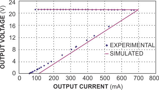

Simulated and measured foldback-current responses to a load resistance that varies from 200 to 0.01 Ω show close agreement.
Figure 2. Simulated and measured foldback-current responses to a load
In a practical design, you select values for IKNEE and ISC and equal values for R3A and R3B and then use equations 1 and 2 to calculate resistors RSC and R4. For the circuit in Figure 1, the output's maximum and short-circuit currents are fixed at 0.7 and 0.05 A, respectively. With R3A and R3B set to 100 Ω, solving the equations yields values of 0.73 Ω for RSC and 4.3 kΩ for R4. You can demonstrate the circuit's performance by applying a variable-load resistor that's adjustable from 0 to 200 Ω. As Figure 2 shows, the output's simulated and measured voltage-versus-current characteristics, VOUT and IOUT, respectively, are in close agreement.
