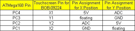

This configuration means that the voltage, ground, and sense bar need to be continually switched in order to quickly read x and y positions. Here is how I hooked up the touchscreen to my ATMega168:
In my code I will need to switch between the x and y pin assignments in order to quickly read the x and y positions.

The hardware for the touchscreen was a simple direct connection to 4 IO pins, 2 of them needing to be ADCs. Power to the screen can be supplied by an output pin being pulled high to 5V and another output pin being pulled low to ground.

Basically, I needed two ADC readings, one for x and one for y. However, I can't just set one pin permanently to one ADC, the pins will need to be constantly changing (refer to the chart above).
I made a function for each coordinate that changes the pin assignments and takes an ADC reading.
