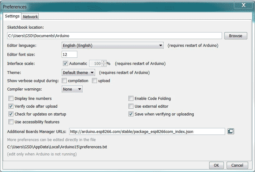

  1. Open Arduino IDE. Go to File > Preferences.
Preferences in Arduino IDE
Figure 5. Preferences in Arduino IDE
  1. Enter http://arduino.esp8266.com/stable/package_esp8266com_index.json into the “Additional Board Manager URLs” field. Now, click the “OK” button.

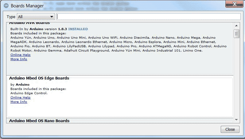

  2. Go to Tools > Board > Boards Manager.
Boards manager in Arduino IDE
Figure 6. Boards manager in Arduino IDE
  1. Search and scroll down ESP8266 board in menu and install “esp8266 by Esp8266 community”.
