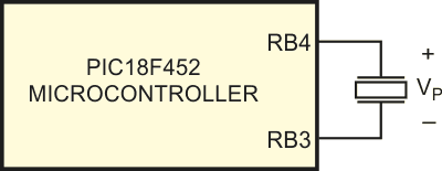

In this design, a Microchip PIC18F452 microcontroller drives a piezoelectric element through its I/O pins, RB4 and RB3 (Figure 2). Initially setting RB3 to zero and RB4 to one and toggling them after each half-period generates an alternating piezoelectric voltage (VP) with a 0 V-dc bias. After applying 10 cycles, RB3 is kept low, and RB4 is made an input to count the low-to-high and high-to-low transitions of VP. Enabling the “interrupt-on-port-change” feature of Port B for 10 msec and incrementing a counter in the interrupt-service routine counts the transition of the piezoelectric voltage. Listing 1 demonstrates this feature. The program repeats these steps for all frequencies of interest and identifies the frequency corresponding to the maximum number of transitions at the resonant frequency. You can easily expand the idea for the case of multiple resonant frequencies.
| Figure 2. | A PIC18F452 microcontroller first drives the piezoelectric buzzer at a programmed frequency and then configures one of its pins as an input to count the residual oscillations. |
