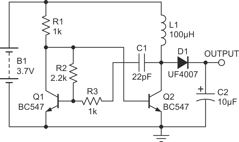

When I was working on a project, I found that I need to drive a buzzer of 12 V from a source of 3.7 V LiPo. But the circuit should not be costly and should be as small as possible. After looking at similar circuits over the net, I found several circuits but only one was satisfactory. After little modification, that circuit becomes very useful to me. That is why I’m sharing this circuit so that you may get some help.
When you need to drive a small load such as a sensor, or a buzzer, or a relay with a battery of 1.5 V, or such a source then you can use this type of DC/DC converters.
Circuit diagram
DC/DC converter using transistors
Figure 1.
Working principle
This is actually an Astable multi-vibrator using Transistors. With a small change in its configuration, this DC/DC converter is designed. The Q1 & Q2 are the same transistors. Once the power is up, the Q2 starts switching until C1 gets charged. Once C1 is charged, Q1 triggers as there is no pull down to its base through R3 & C1. This turns Q2 off. Once Q2 is off, as C1 was charged, it triggers Q2 through R2 and R3. This process keeps going until power is sufficient.
