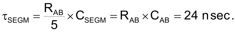

The five-step distributed RC line of the potentiometer has a time constant of
where RAB is 20 kΩ. The ground-referred wiper capacitance, CW, of 40 pF is much higher than the intercapacitances and creates a time constant:
The feedback network of the amplifier is frequency-compensated for τSEGM ≈ τW. Thus, you can calculate the value of RWB as 600 Ω, meaning that the voltage gain of the amplifier, AV, is 32.3. For gains higher than 32.3, the effect of CW becomes negligible, and you need not bother about amplifier stability. To suppress the derivative behavior of the amplifier for gain values of two to 32.3, you can add a 40-pF compensating capacitor in parallel to feed back part of the potentiometer. The amplifier thus has an integrating character for all gains down to a value of two.
