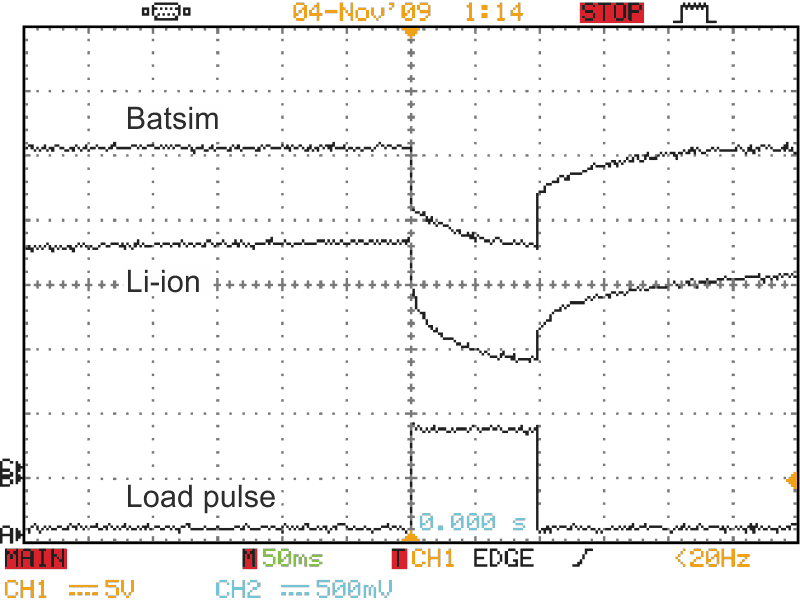

| Figure 2. | With no feedback capacitor, the simulator closely matches the response of a large lithium-ion battery. |
Applying a 1 A load pulse without the capacitor in the feedback network causes the simulator response to closely follow the response of a 2000-mA•hr lithium-ion 18650 battery (Figure 2). You can also add the capacitor to the feedback network to make the simulator better represent the response of a small, 200-mA•hr lithium-ion battery (Figure 3). With proper adjustment of the circuit, you can produce many response curves.
| Figure 3. | Adding capactive feedback causes the simulator to act like a much smaller battery. |
