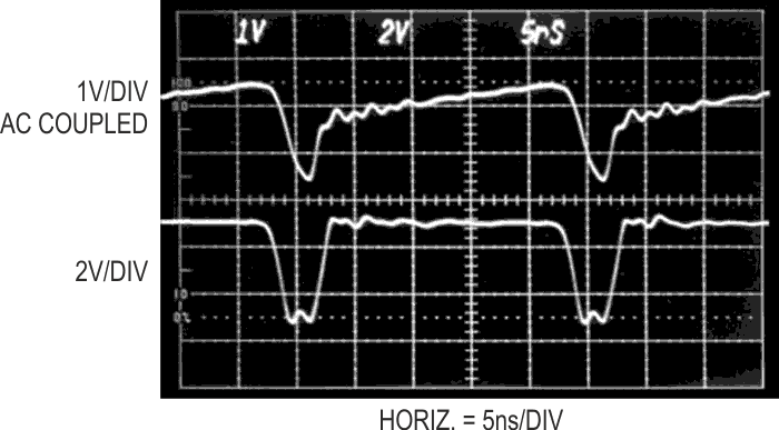

The positive input voltage causes A1 to swing negatively, biasing Q1. Q1’s resultant collector current ramps C1 (trace A, Figure 2) until Schmitt trigger inverter I1’s output (trace B) goes low, discharging C1 via Q2. C1’s discharge resets I1’s output to its high state, Q2 goes off and the ramp-and-reset action continues. D1’s leakage dominates all parasitic currents in the core oscillator, ensuring operation down to 1 Hz. The ÷64 divider chain’s output clocks the LTC6943-based charge pump. The charge pump’s two sections operate out-of-phase, resulting in charge transfer at each clock transition. Charge pump stability is primarily determined by the LT1460 2.5 V reference, the switches low charge injection and the 100 pF capacitors. The 0.22 μF capacitor averages the pumping action to DC. The averaged difference between the input derived current and the charge pump feedback signal is amplified by A1, which biases Q1 to control circuit operating point. Core oscillator nonlinearity and drift are compensated by A1’s servo action, resulting in the high linearity and low drift previously noted. A1’s 1 μF capacitor provides stable loop compensation. Figure 3 shows loop response (trace B) to an input step (trace A) is well controlled.
V-F operation at 40 MHz. Core oscillator waveforms viewed in 670 MHz real time bandwidth include Q1 collector (Trace A) and Q2 emitter (Trace B). Ramp-and-reset operating characteristic is apparent; reset duration of 6ns permits 100 MHz repetition rate.
Figure 2. V-F operation at 40 MHz. Core oscillator waveforms viewed in 670 MHz
Some special techniques enable this circuit to achieve its specifications. D1’s leakage current dominates all parasitic currents at I1’s input; hence Q1 must always source current to sustain oscillation, assuring operation down to 1 Hz. The 100 MHz full-scale frequency sets stringent restrictions on core oscillator cycle time. Only 10 ns is available for a complete ramp-and-reset sequence. The ultimate speed limitation is the reset interval. Figure 2, trace B, shows a 6 ns interval, comfortably within the 10 ns limit.
