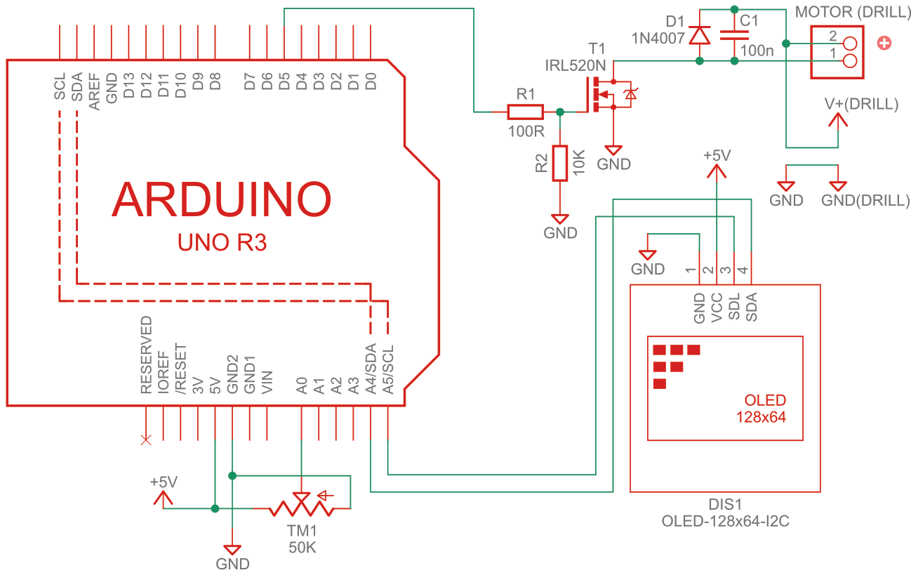

Finally, Figure 6 is the self-explanatory schematic for you to follow.
Schematic diagram of a handheld electric drill controller.
Figure 6. Schematic diagram of a handheld electric drill controller.
So, now you have a budget replacement for the old-hat 555 timer based PWM controller to regulate speed of a dc motor. A small number of parts, display panel to show the drive level, and room of creative betterments by tweaking the firmware makes it a much better alternative. Of course, governing the speed of an electric drill is not the only application for a power PWM driver like this, so use it for whatever you fancy. Have Fun!
