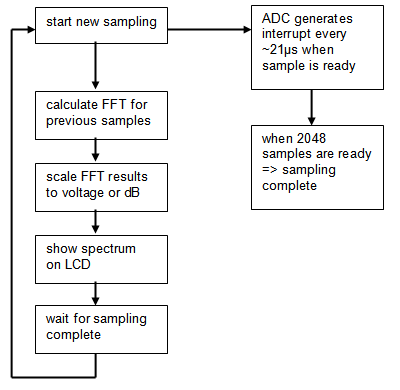

Here’s basic main loop flowchart:
Audio spectrum analyzer on PIC32: loop flowchart
PIC’s ADC is configured to take samples at ~48kHz frequency. When each sample is converted interrupt is generated and sampled value is placed to the buffer. Sampling is completed when 2048 point buffer is full. It takes about 42ms at 48kHz sampling frequency.
Since sampling is done automatically in background we have enough time to do all calculations to previous samples while sampling new ones. First fast Fourier transform is calculated, then the results of FFT are scaled to volts or decibels and finally spectrum is drawn on LCD. At 80MHz it takes about 35ms to do all calculations and draw image on the screen.
