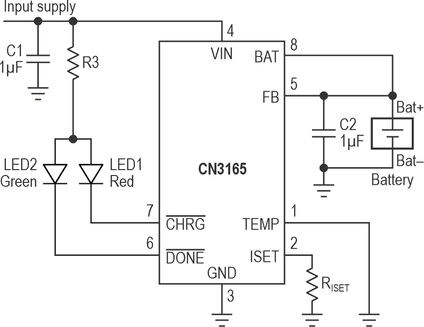

Circuit diagram
I have read the datasheet, and it depicts the application circuit with some protection features added on. The datasheet circuit is in Figure 1.
The CN3165 application circuit from datasheet.
Figure 1. The CN3165 application circuit from datasheet.
Here we need a resistor to set the maximum output battery charging current, a capacitor on battery terminal for power supply noise cancellation. And a few led indicators for battery changing and done mode. In single cell operation the feedback pin is directly connected to the battery terminal and continuously monitors the battery voltage for automatic charging restart and power down. The same charging IC can be used to charge more than 1 battery @1 Amp maximum by feeding the feedback pin with voltage dividers.

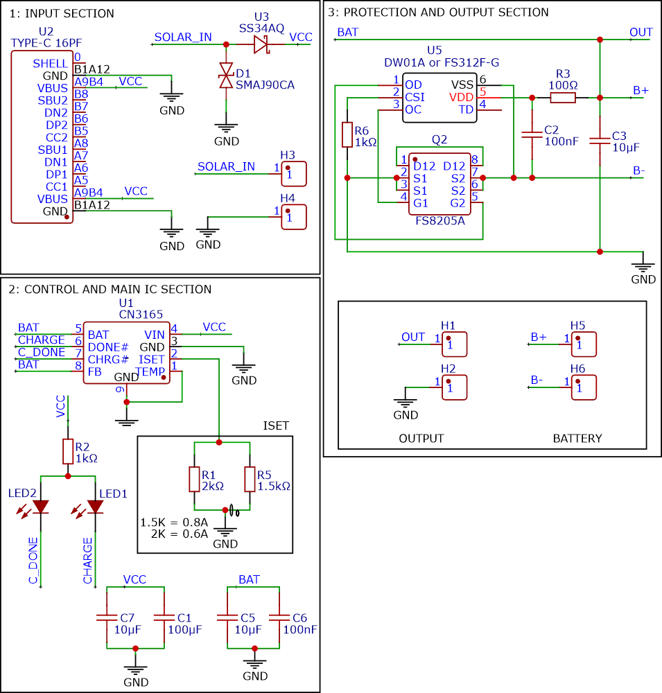

Modified circuit
I modified the circuit to add some external protection features (Figure 2). I have added a USB type C input, a TVS diode to reject any spike in solar output and a forward bias diode to make it polarity friendly, which can be seen in the schematics.
Modified charger circuit
Figure 2. Modified charger circuit.
In section 2, IC is placed itself with 2 resistors to set the current, led indicators and some coupling capacitors for the IC.
In section 3, output is taken from a pin header, and it also contains the same protection circuit which is there on TP4056. All this packed into a small form factor.

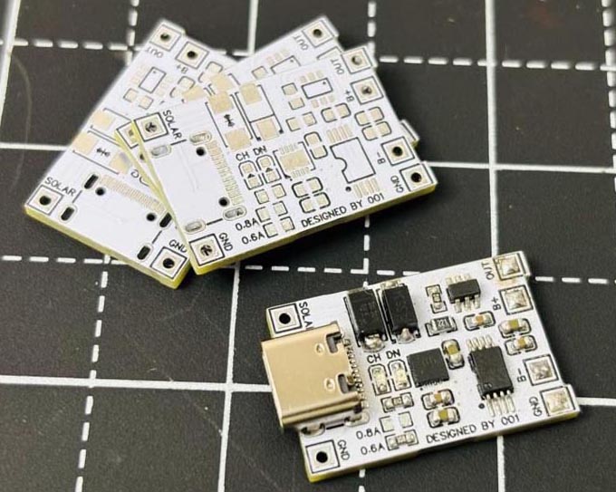

PCB layout
This is the hardware level design I have implemented keeping all the noise and stabilization problems in mind. Tracks are made with enough calculations to carry max current hence delivering maximum power and reduce heat effects. Two onboard status LEDs is to monitor battery charging. And to keep all the effects of switching section minimal on the input and output the PCB is divided according to the input to output flow. I kept the form factor same as TP4056 board, which makes this design more practical and easier to use as a standalone battery charging device. For input power USB type C and solder pads are given same as TP4056 design.
BOM and assembly considerations
When soldering, the best practice is to mount the IC and USB connector first. Then small capacitors, resistor and then inductor. Because the IC pad and USB connector are very hard to solder with hand (Figure 3).
The assembled circuit board.
Figure 3. The assembled circuit board.

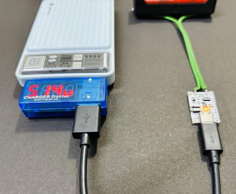

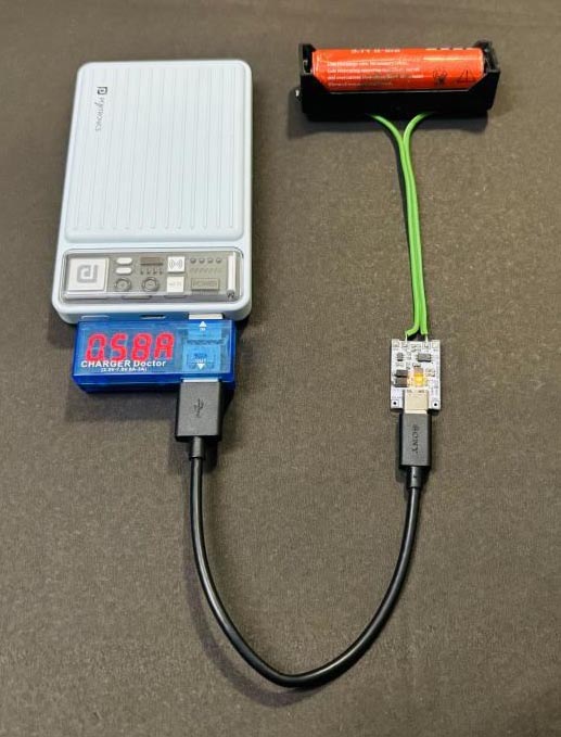

Testing and working
Solar charging.
Figure 4. Solar charging.
I powered on the board after assembling it with a power supply set to max current limit of 100 mA so that if anything goes wrong, it will not damage anything. But worked in the first go, all the connections are correct, but always check the VCC and GND lines continuity before powering ON. So, I connected a 3.9 V Li-ion battery with a max charge voltage of 4.2 V. The default charging current is set. The charging current rating should match the battery rating, so I always recommend using a high C rated battery, while charging with 3 A. See Figures 4 and 5.
Simple charging.
Figure 5. Simple charging.
When charging the battery at full potential a very little heat is produced, which satisfies the 94% efficiency of this IC. I also have tested all protection features and all of them are working very normally. It is always recommended to check the output voltage of the board which should be in the range of 4.15-4.22 volts for the Li-ion battery.
