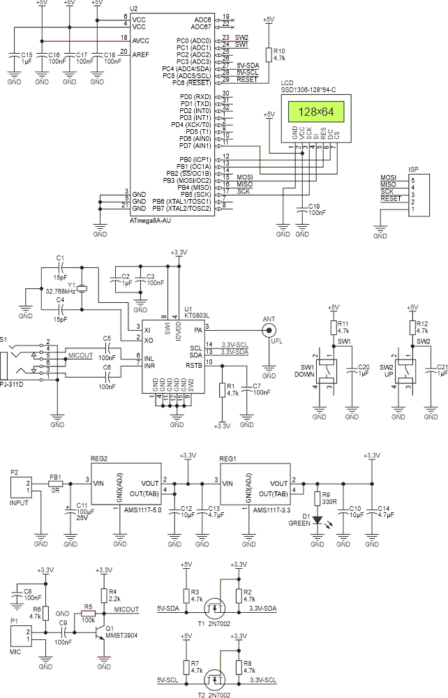

Figure 1 shows the schematic diagram of the digital 87 MHz to 108 MHz FM transmitter. It consists of several parts which I explain one by one.
Schematic diagram of the digital FM transmitter project.
Figure 1. Schematic diagram of the digital FM transmitter project.
Power supply
P2 is an XH connector to apply power to the board. The input voltage could be something between 7-9 VDC. FB1 and C11 build a lowpass filter to reduce input noises. REG2 is the TLV1117-5.0 regulator to prepare the +5 V voltage rail. C12 and C13 are used to stabilize the output voltage of the regulator and reduce noise. REG1 is the TLV1117-3.3 regulator to prepare the +3.3 V voltage rail. D1 is an LED to indicate the proper supply connection and C10 and C14 are used to stabilize the output and reduce the noise.
Microphone input
P1 is an XH connector to connect your electret microphone to the board. C8 is a decoupling capacitor to reduce the noise and R6 prepares a supply rail for the microphone. C9 removes the signal DC element and Q1 amplifies the weak microphone signals to be delivered to the FM transmitter chip.
Logic level converter
T1 and T2 are 2N7002 N-Channel MOSFETs that are used to convert the 5 V I2C logic level from the microcontroller (U2) to the 3.3 V logic level to be applied to the FM Transmitter chip (U1). R2, R3, R7, and R8 are pull-up resistors to complete the circuit.
FM transmitter
The main component of this part is the KT0803L chip (U1). S1 is an SMD headphone jack used to connect an AUX cable to the board. This allows you to transfer sound from your mobile phone, PC, or other device to the board. C5 and C6 are used to transfer the acoustic signal to U1. C2 and C3 are decoupling capacitors, and ANT is a UFL connector that provides an interface for your telescopic antenna to the board.
Microcontroller and display

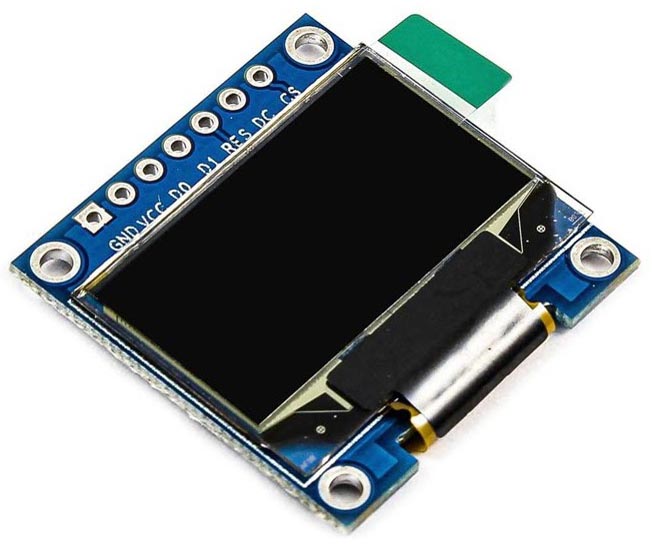

The heart of the circuit is the ATmega8-AU microcontroller (U2). C15...C18 are decoupling capacitors to reduce the noise. R10 is a pullup resistor for the RESET pin. LCD is the SPI 0.96-inch 128×64 OLED display, as shown in Figure 2. C19 is a decoupling capacitor for the supply pin of the LCD. SW1 and SW2 are tactile pushbuttons to increase and decrease the frequency. C20 and C21 are used to debounce the pushbuttons and R11 and R12 are pullup resistors. ISP prepares the necessary AVR-ISP pins to flash the MCU. Although not mandatory, you may choose to solder a pin header in place.
A picture of the 0.96-inch 128×64 yellow-blue SPI OLED display.
Figure 2. A picture of the 0.96-inch 128×64 yellow-blue SPI OLED display.

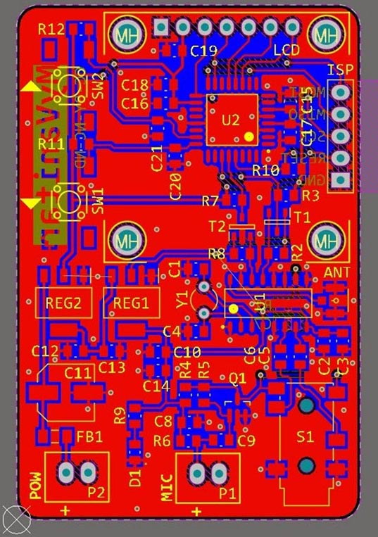

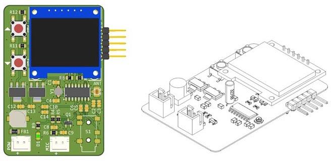

Figure 3 shows the PCB layout of the design. It’s a two layers PCB board and almost all components are SMD. Figure 4 shows the board assembly drawings.
Board assembly drawings of the digital FM transmitter project.
Figure 4. Board assembly drawings of the digital FM transmitter project.

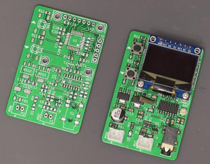

Assembly and test
Soldering the components should not be an issue, as the smallest package size is 0805 or the UFL connector. Figure 5 displays the assembled board.
Assembled board of the digital FM transmitter project.
Figure 5. Assembled board of the digital FM transmitter project.
