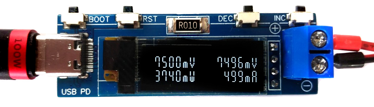

The USB PD adapter shown in Figure 1 is is a compact variable power supply capable of utilizing nearly any USB Type-C PD power supply with PPS-feature as an input to power your projects with various selectable voltages and high currents. Key parameters such as voltage, current, power, and energy are conveniently displayed on the OLED screen. This adapter is built around the cost-effective (30 cents at the time of writing) and user-friendly CH32X035 32-bit RISC-V microcontroller, which features hardware USB PD support, along with the INA219 voltage and current sensor IC.
USB PD adapter.
Figure 1. USB PD adapter.

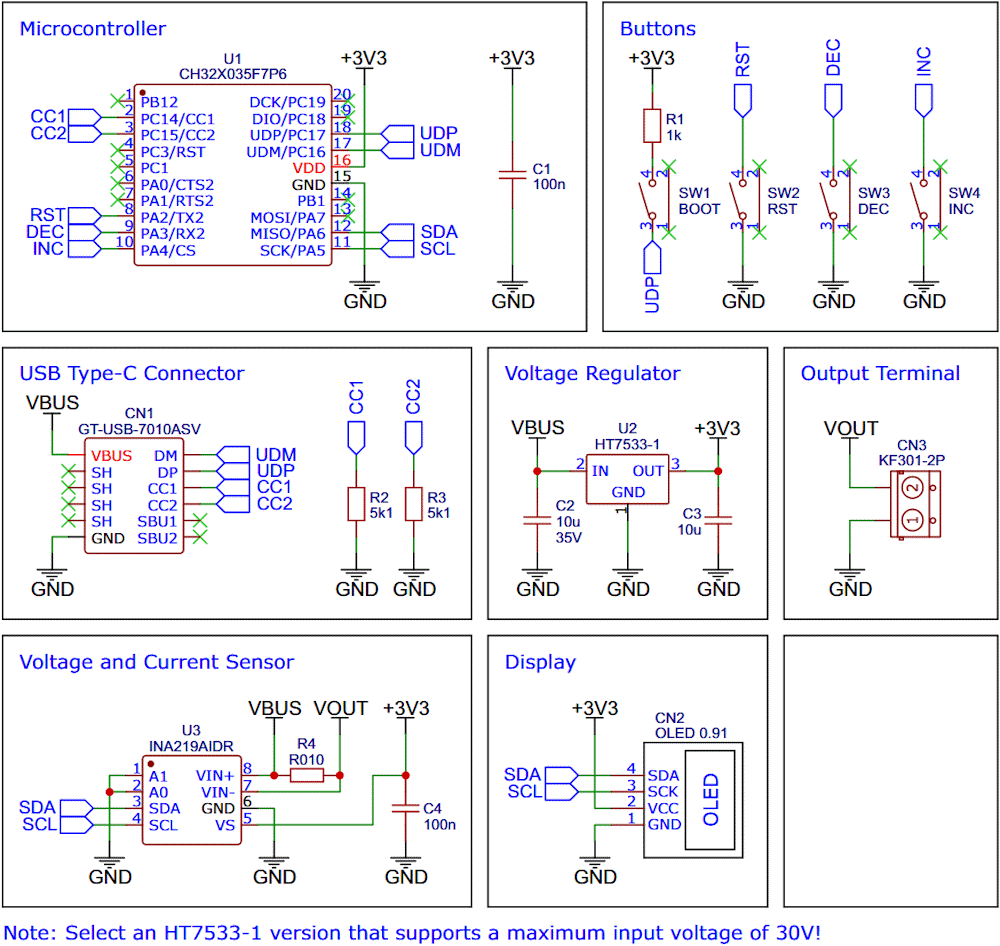

Schematic
Schematic diagram of the USB PD adapter.
Figure 2. Schematic diagram of the USB PD adapter.
Figure 2 shows the schematic diagram of the USB PD adapter. Table 1 shows the bill of materials.

CH32X035 F7P6 32-bit RISC-V USB microcontroller
CH32X035F7P6 is a low-cost microcontroller that utilizes the QingKe 32-bit RISC-V4C core, supporting the RV32IMAC instruction set along with self-extending instructions. This microcontroller comes with a built-in USB PHY, supporting USB2.0 full-speed device functions and a USB PD PHY with source and sink capabilities. It features a programmable protocol I/O controller (PIOC), an operational amplifier (OPA) with programmable gain (PGA), an analog comparator (CMP), a 12-bit analog-to-digital converter (ADC), an 11-channel touch-key controller, 3 groups of USART, I2C, SPI, multiple timers, and various other peripheral resources. The device can operate at clock frequencies of up to 48 MHz and is compatible with a supply voltage range of 2.0 V to 5.5 V. The CH32X035F7P6 includes 48 KB of flash, 20 KB of SRAM, and an embedded USB bootloader.
The CH32X035 microcontroller manages several tasks, including power negotiation with the USB PD power supply, INA219 management, user interface control, and computation and presentation of measured values. The user interface is comprised of three buttons and an SSD1306 I2C OLED display with a resolution of 128×32 pixels.
INA219 current/power monitor
The INA219 is a current shunt and power monitor with an I2C-compatible interface. The device monitors both the shunt voltage drop and bus supply voltage, with programmable conversion times and filtering. A programmable calibration value, combined with an internal multiplier, enables direct readouts of current in amperes.
The selected shunt resistance of 10 mΩ enables both a very small influence on the circuit and a measurement with a resolution of 1 mA. For accurate measurement, a shunt resistor with a low tolerance (1% or better) should be selected. The INA219 is used here to measure the output voltage and output current. It communicates with the MCU via I2C.
HT7533-1 voltage regulator
The HT75xx-1 series comprises three-terminal high current low voltage regulators crafted using CMOS technology. They are capable of delivering an output current of 100 mA and can handle input voltages as high as 30 V. The utilization of CMOS technology guarantees minimal voltage drop and low quiescent current.
The HT7533-1 provides a stable 3.3 V supply to all components of the circuit. Ensure that you select a version with a maximum input voltage rating of 30 V.
SSD1306 OLED display module
A low-cost SSD1306 4-pin I2C 128×32 pixels 0.91-inch OLED module is used as the display device. Make sure to acquire one with the correct pinout!

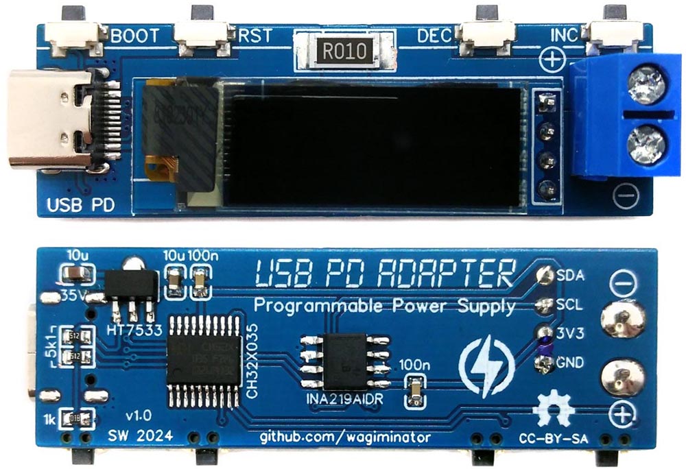

Building instructions
  1. Take the Gerber files (download them from the Downloads section) and upload them to a PCB manufacturer of your choice. They will use these files to create the circuit board for your device and send it to you.
  2. Once you have the PCB, you can start soldering the components onto it. Remove the plastic part from the pin header of the OLED, trim the pins, and solder the OLED module flush onto the PCB.
  3. Upload the firmware by following the instructions in the next section (see below).
Figure 3 shows the assembled PCB board.
Assembled PCB board of the USB PD adapter.
Figure 3. Assembled PCB board of the USB PD adapter.

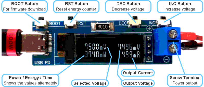

Operating instructions
  1. Connect the USB PD Adapter to a USB Type-C PD power supply using a USB-C cable.
  2. Use the INC/DEC buttons to select the desired output voltage in steps of 20 mV (See Figure 4)..
  3. Connect the device to the power consumer via the output screw terminal.
  4. Use the RST button to clear the energy counter.
USB PD adapter user interface.
Figure 4. USB PD adapter user interface.
