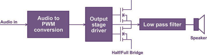

Many parameters have to be taken into consideration before getting to a decently audible class D amplifier. Each element of the signal chain must be adequately controlled to achieve a good audio signal through the whole audible frequency range. Figure 2 shows a simple typical signal chain block diagram for digital amplifiers. Every single detail will have to be adjusted to reach a certain balance that satisfies the ear.
Class D signal path block diagram
Figure 2. Class D signal path block diagram.
