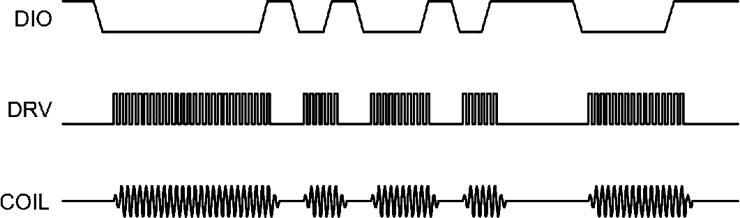

Designed specifically to support this initiating function, the Atmel ATA5276 IC drives 125 KHz LC resonant tank circuits that initiate this wake-up process. Controlled by an MCU through a simple one-wire interface, the ATA5276 combines control logic with a VCO to generate the 125 KHz signal used to drive the initiator LC coil circuit. By driving the device's DIO pin with data rather than using a simple "enable" signal, engineers can also use the ATA5276 to transmit ASK-modulated data to TPMS units (Figure 1).

Figure 1. Besides providing simple wake-up signals, the Atmel ATA5276 can transmit data to TPMS units: Driving DIO with data toggles DRV, resulting in ASK modulated signals at the coil. (Courtesy of Atmel.)
