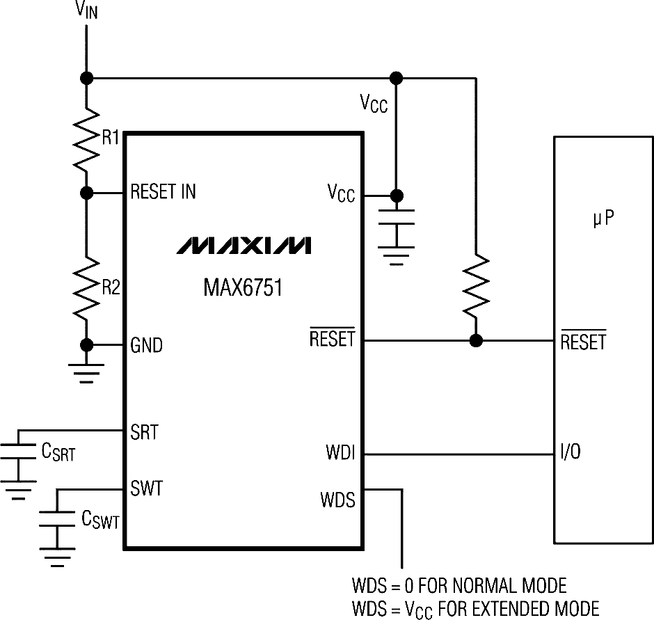

One external WWDT is Maxim’s MAX6751. It has a WWDT whose timeouts are controlled by capacitors, as shown in Figure 1.
The MAX6751’s timeouts are set by a pair of capacitors
Рисунок 1. The MAX6751’s timeouts are set by a pair of capacitors (Courtesy Maxim).

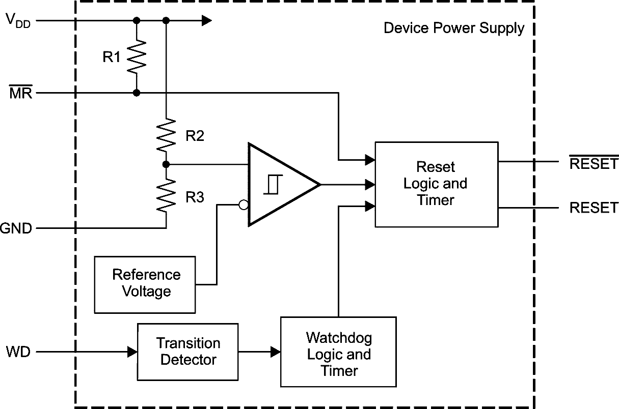

Texas Instruments’ TPS3126 is similar to a WWDT without the window capability. They are available for a variety of supply voltages and delay times, are inexpensive, and come in SOT-23 packages. Figure 2 outlines their configuration.
TI’s TPS3126 monitors power as well as have WDTs
Figure 2. TI’s TPS3126 monitors power as well as have WDTs (Courtesy Texas Instruments).

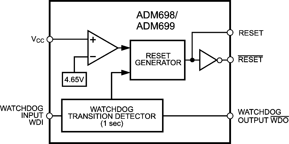

Analog Devices' ADM699 is a simple WDT which also monitors one supply. Figure 3 shows its implementation.
The ADM699 has a very clean and simple design
Figure 3. The ADM699 has a very clean and simple design (Courtesy Analog Devices).

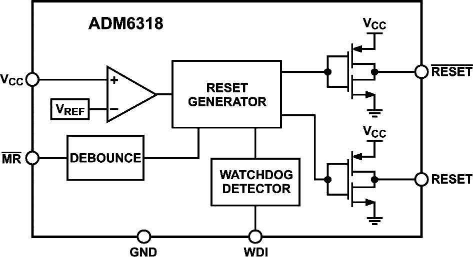

Some microprocessors now are very particular about the reset input, tolerating only relatively rapid slew rates and signal levels. An open drain drive can meet those requirements only by using a very low-value pull-up resistor, which increases power consumption. Analog Devices has several components, like the ADM6316, that use a push-pull output to meet these stringent requirements. Figure 4 shows the part’s block diagram.
The ADM6316 has push-pull drivers
Figure 4. The ADM6316 has push-pull drivers (Courtesy Analog Devices).
