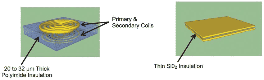

Digital isolators use transformers or capacitors to magnetically or capacitively couple data across an isolation barrier, compared to optocouplers that use light from LEDs.
Transformers pulse current through a coil, as shown in Figure 1, to create a small, localized magnetic field that induces current in another coil. The current pulses are short, 1 ns, so the average current is low.
Anatomy of a Digital Isolator
Figure 1. Transformer with Thick Polyimide Insulation Where Current Pulses Create Magnetic Fields to Induce Current on the Secondary Coil (left); Capacitor with Thin SiO2 Insulation Using Low Current Electric Fields to Couple Across Isolation Barrier (right).
Transformers are also differential and provide excellent common-mode transient immunity, as high as 100 kV/µs (optocouplers are typically about 15 kV/µs). Magnetic coupling also has a weaker dependence on the distance between the transformer coils compared with the dependence for capacitive coupling on the distance between plates. This allows for thicker insulation between transformer coils resulting in higher isolation capability. Combined with low stress polyimide films, high levels of isolation may be achieved for transformers using polyimide vs. capacitors using SiO2.
Capacitors are also single-ended and have higher susceptibility to common-mode transients. Differential pairs of capacitors can compensate, but this increases size and cost.

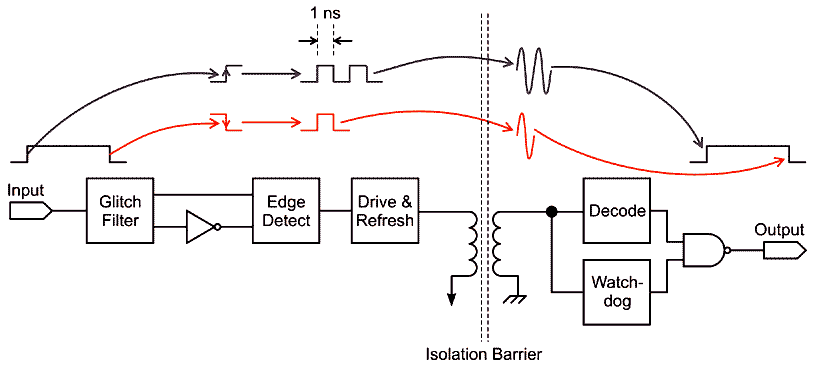

One method encodes rising and falling edges as double or single pulses that drive a transformer (Figure 2). These pulses are decoded back into rising/falling edges on the secondary side. This reduces power consumption by 10× to 100× compared to optocouplers because power is not continuously applied as with optocouplers. Refresh circuits can be included to regularly update the dc level.
Figure 2. One Method for Transferring Data Encodes Edges as Single or Double Pulses.
