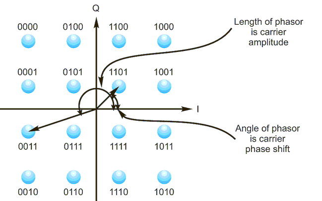

One unique form of multilevel modulation is quadrature amplitude modulation (QAM). QAM uses a mix of different amplitude levels and phase shifts to create the symbols representing multiple bits. For example, 16QAM encodes four bits per symbol. The symbols are a mix of different amplitude levels and different phase shifts.
A constellation diagram is typically used to illustrate the amplitude and phase conditions of the carrier for each 4-bit code (Fig. 2). Each dot represents a specific carrier amplitude and phase shift. A total of 16 symbols encodes four bits per symbol, ultimately quadrupling the bit rate over the baud rate.
 A constellation diagram for 16QAM shows the 16 possible carrier amplitude and phase combinations representing four bits per symbol
 Figure 2. A constellation diagram for 16QAM shows the 16 possible carrier amplitude and phase combinations representing four bits per symbol.
