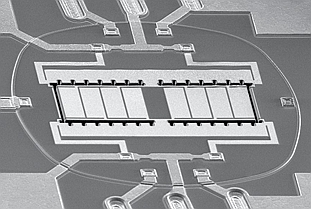

MEMS in two variations: electrostatic versus piezoelectric
Quartz oscillators make way for MEMS
Figure 1. The electrostatic technique for building a MEMS resonator uses an electric field interacting with a moving element.
There are two distinct design approaches to building MEMS-based timing devices: electrostatic and piezoelectric. In the first, a movable silicon MEMS element interacts with the carefully controlled electric field surrounding it. This electrostatic, or capacitive actuation, results in the core of the MEMS resonator performance (Figure 1). In the second, the MEMS resonator uses piezoelectric actuation to convert mechanical motion and stress to an electrical signal, and vice versa (Figure 2).
Figure 2. The piezoelectric approach is based on a long-established principle of material stress and voltage, and offers the potential for improved resonator performance.

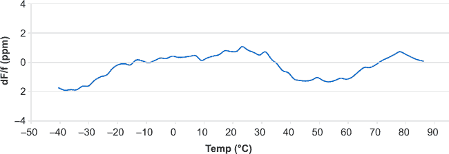

Regarding the first challenge to displacing quartz – achieving high frequency stability over temperature – electrostatic MEMS designers typically implement a digital synthesizer on the oscillator circuit to compensate for over 3000 ppm of drift over -40°C to +85°C. While this technique effectively addresses drift, it unfortunately has a downside: It introduces significant additional jitter and phase noise as well as increased current consumption, often beyond what higher-end applications can accept.
In contrast, piezoelectric MEMS manufacturers such as Sand 9 address drift by using a combination of techniques that yield better jitter and phase noise performance than synthesizer compensation. First, the piezoelectric MEMS resonator – a monolithic element – is laminated with a layer of silicon dioxide (SiO2) on both sides, which hardens the element and reduces drift by more than an order of magnitude. Second, associated oscillator circuitry incorporates an analog compensation loop, which is both faster than a digital synthesizer and also introduces far less phase noise and jitter. A well-designed MEMS oscillator such as from Sand 9 can achieve ±5 ppm and better stability over -40°C to +85°C, comparable to quartz designs, (Figure 3).
Figure 3. The normalized frequency drift of the compensated Sand 9 device is comparable to quartz, over the entire range of operating temperature.

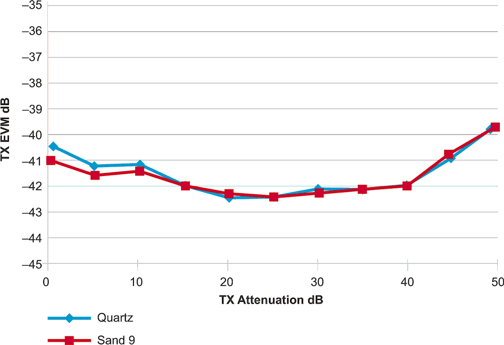

When considering jitter/phase noise and power consumption, the electrostatic architecture has unavoidable low coupling between its mechanical and electrical modes, resulting in inefficient energy conversion. The energy coupling of the electrostatic design is about one-hundredth that of the piezoelectric design. The result is lower signal-to-noise ratio (SNR) and inferior jitter/phase noise at the output.
To compensate for lower SNR and to raise performance, the electrostatic device must be larger in size, driven with more power, or both; thus, the completed electrostatic device requires significantly more current than a comparable piezoelectric device. Higher current renders the electrostatic device unsuitable as a cellular transceiver reference, and despite consuming more current, it is still unable to deliver the low jitter/phase noise for precision timing applications in, for example, communications infrastructure equipment (Figure 4).
Figure 4. LTE transmitter error vector magnitude versus attenuation for both Sand 9 MEMS and quartz shows comparable performance despite the differences in size and cost.
