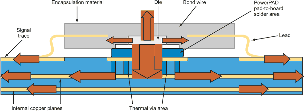

For example, the common exposed-pad approach used for interconnecting an IC chip to a PCB may increase heat problems. When soldering the exposed path to a PCB, the heat travels quickly out of the package and into the board. The heat then dissipates through the board’s layers and into the surrounding air.
Thus, Texas Instruments (TI) devised a PowerPAD method that mounts the IC die to a metal plate (Fig. 1). This die pad, which supports the die during fabrication, serves as a good thermal heat path to remove the heat away from the chip.
Warm Up To The Latest PCB Cooling Techniques
Figure 1. The die pad in Texas Instruments’ PowerPAD supports the die during fabrication, thus serving as a good thermal heat path to remove the heat away from the chip.

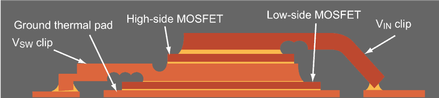

According to Matt Romig, analog packaging product manager at TI, its PowerStack method is the first 3D packaging technology to stack high-side vertical MOSFETs. It combines both high-side and low-side MOSFETs held in place by copper clips and uses a ground potential exposed pad to provide thermal optimization (Fig. 2). Employing two copper clips to connect the input and output voltage pins results in a more integrated quad flat no-lead (QFN) package.
Figure 2. TI’s PowerStack 3D packaging technology stacks high-side vertical MOSFETs. It combines both high-side and low-side MOSFETs held in place by copper clips and uses a ground potential exposed pad to provide thermal optimization.

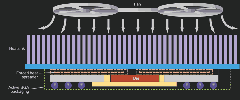

Azar envisions one solution that minimizes spreading resistance, the largest resistance in the path of heat transfer, with a forced thermal spreader bonded directly to the microprocessor die (Fig 3).
Figure 3. An embedded thin-film thermoelectric device proposed by Advanced Thermal Solutions uses water-cooled microchannels. A forced thermal spreader that’s bonded directly to the microprocessor die minimizes spreading resistance, the largest resistance in the path of heat transfer. (Source: “Cooling High-Power Packages,” Kaveh Azar, Advanced Packaging)
This approach distributes the concentrated heat of a small microprocessor die to the larger base area of the heatsink, which transfers the heat to the ambient environment. Such a built-in forced thermal spreader combines micro and mini channels in the silicon package. The water flow rate inside the channels is approximately 0.5 to 1 liter/minute.
Simulation results showed that on a 10- by 10-mm die within a ball-grid-array (BGA) package, a 120- by 120-mm heatsink base-plate area yielded a thermal resistance of 0.055 K/W. Using a heatsink material with thermal conductivity equal to or higher than diamond yielded 0.030 K/W.

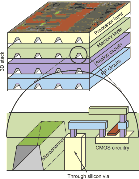

IBM plans to use microchannel water cooling for its future 3D IC processors, such as the Power8 processor scheduled for introduction in 2013 (Fig. 6). Bruno Michel, manager of the Advanced Thermal Packaging Group for IBM’s Zurich, Switzerland research facility, says that energy-efficient, hot-water cooling technology is part of IBM’s concept of a zero-emissions data center. To cool 3D chip stacks, which generate more heat than a single processor in nearly the same space, water rather than air was used to reduce energy consumption.
Figure 6.   IBM plans to use microchannel hot-water cooling for future 3D IC processors, such as the Power8 processor due to arrive in 2013.
