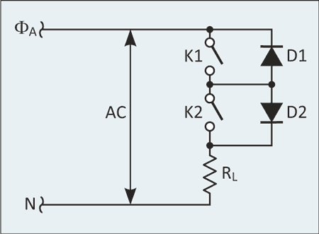

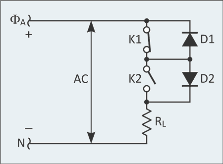

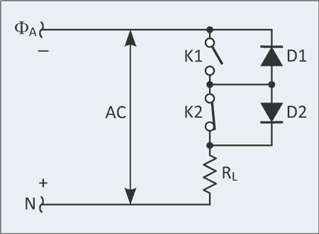

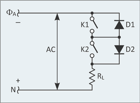

Figure 1. The state of switches K1 and K2 when the SSR is off. Figure 2. When K2 is closed, the SSR is on. Phase A is positive, so D1 blocks and no current flows.
Fig. 1 shows the state of the circuit when the FETs (K1 and K2) are off. The diodes block in both directions so no current flows to the load (RL). When K2 is closed (Fig. 2), the SSR is on. Phase A is positive so D1 blocks and no current flows. K2 can be turned on slowly (several hundred microseconds); because the blocking diode (D1) will not allow the current to flow so the speed or accuracy of turning on K2 is not crucial.

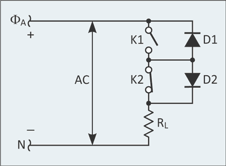

Figure 3. When phase A goes negative, current flows immediately, starting at the zero crossing, through K2 and D1. Figure 4. When K1 finally closes, current flows primarily through K1 and K2 in both directions in phase with
the supply voltage.
When phase A goes negative (Fig. 3), current flows immediately, starting at the zero crossing, through K2 and D1. During this first cycle of operation, K1 can be turned on slowly. Fig. 4 shows the state of the circuit when K1 finally closes. Current now flows primarily through K1 and K2 in both directions in phase with the supply voltage. Fig. 5 shows the sequence when the SSRs are turned off. When phase A becomes positive, K2 can be opened slowly and D2 will carry the current. (This doesn't interrupt the current until the next step.)

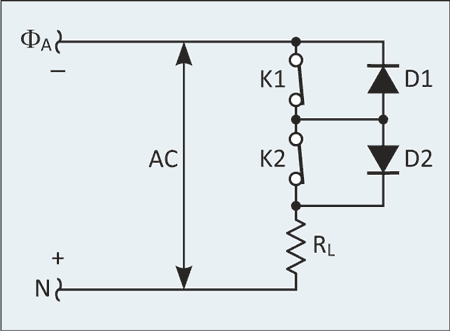

Figure 5. When the SSR is off and phase A becomes positive. K2 can be opened slowly and D2 will carry the current. Figure 6. When phase A goes negative. K2 is open and D2 is now blocking, so (he load current ceases and K1 can be turned off slowly.
When phase A goes negative in Fig. 6, K2 is open and D2 is now blocking, so the load current ceases and K1 can be turned off slowly (several hundred microseconds, for example).
The end result is a load current that starts and stops with no discernible “step” at the zero crossing points. An additional feature is inherent “integral cycle control” (i.e., only full cycles are delivered to the load), a desirable feature when used with loads that are sensitive to magnetic flux saturation.

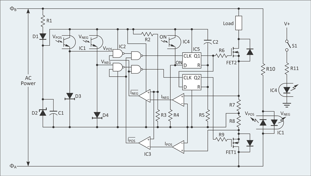

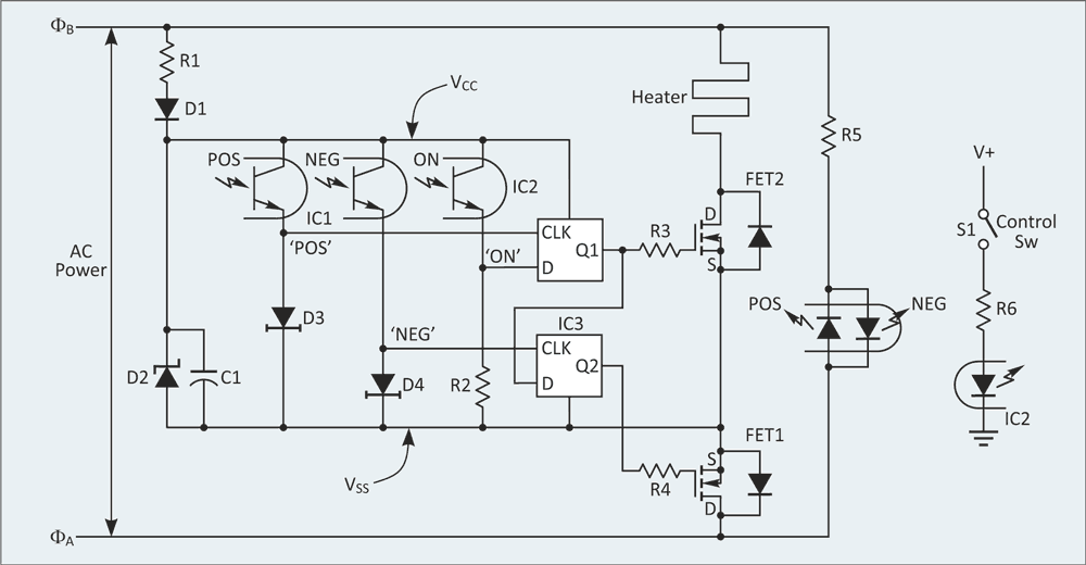

Figure 7. The actual TATTOO circuit.
Fig. 7 shows an actual circuit, and its timing diagram is shown in Fig. 8. The floating VCC in Fig. 7 is referenced to the sources of the two MOSFETs so that any command signals will be properly referenced. Diode (D1) half-wave rectifies the AC through (R1 and D2) and the parallel connected diode (in FET1). C1 holds up the VCC during the AC reversal. The values of these components will vary depending on the AC voltage and frequency and the acceptable ripple on VCC.

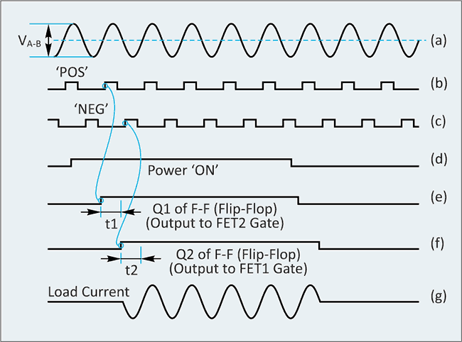

Figure 8. Timing diagram for the TATTOO circuit.
Optocoupler IC1 develops pulses (“POS” and “NEG”) when phase A goes positive or negative with respect to phase B. These pulses appear at the anode of D3 and D4 (active pull-down devices) and are fed to the clock inputs of the two flip-flops of IC3. One pulse appears every half cycle of the AC waveform, so the flip-flops are clocked at alternate half cycles. As long as IC2 is not on, R2 pulls the data line of the top flip-flop low, and each clock pulse will clock a low to the Q1 output keeping FET2 off. Q1 is also fed to the data input of the lower flip-flop and because it is low, FET1 will be off.

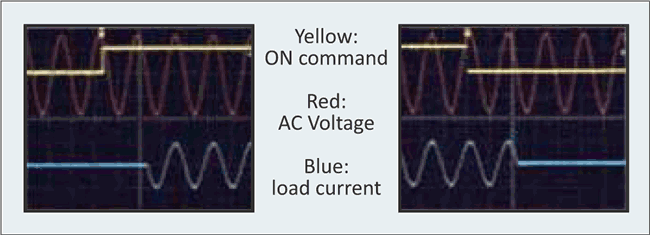

Figure 9. Scope traces show the time relationship of the ON command to the power line voltage and the turn on and off of the load current
This state of affairs continues until S1 (control switch) is turned on. When S1 is turned on, optocoupler IC2 turns on, and a high signal (“ON”) is applied to the D input of the top flip-flop. The next time a “POS” pulse appears, it clocks “ON” into the flip-flop setting Q1 high and turns on FET2. Phase A is positive at this time, so no current will flow through the load (blocked by FET1). Q1, however, is now high and is applied to the data line of the lower flip-flop. At the next phase reversal of the power line (“NEG”), “ON” will be clocked into the lower flip-flop and sets Q2 high, turning on FET1. Although the FET won't turn on immediately, the parallel diode will, and FET1 will conduct fully sometime later in the half-cycle, but the time is not critical. The circuit is now fully conducting and will turn off in the reverse order when the control switch is turned off. The scope traces in Fig. 9 show the time relationship of the ON command to the power line voltage and the turn-on and -off of the load current. Note the load current turns on and off at the zero crossing after the next complete AC voltage waveform after the ON command. Also note the bounce of the ON command has no effect on the load current. This circuit is intended for single-phase operation but can be repeated three times for a 3-phase SSR.

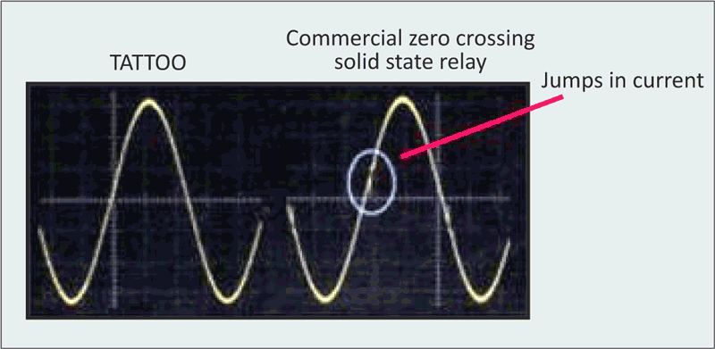

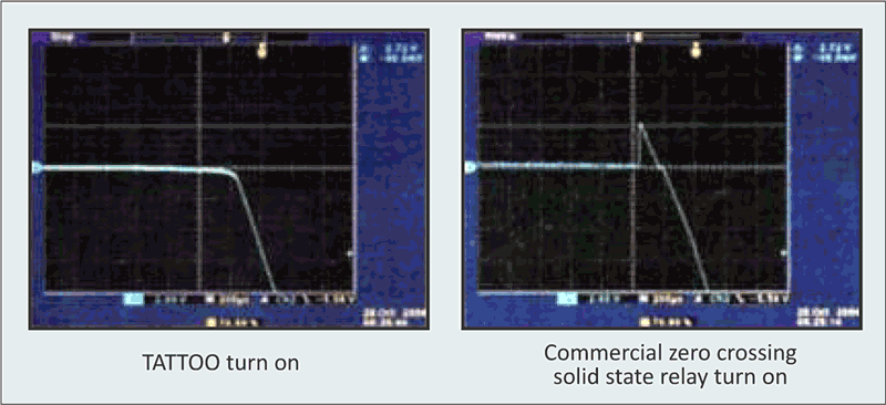

As stated before, some present commercial SSRs have a window of voltage that yields a fairly close operation to the zero-voltage crossing point but may not be acceptable for higher current operations or high frequencies. Fig. 11 shows the operation of a general commercial SSR with ZVS compared to TATTOO. The first oscilloscope plot shows an expanded view of the load current (60-Hz, 115-Vac supply) being applied to a load using the TATTOO circuit. The second plot shows the same load being turned on but using a commercial SSR with ZVS instead.
Novel Zero Crossing SSR Technique/Circuit
Figure 11. Other products claim to operate at the zero-voltage crossing, but may not be as precise as the TATTOO circuit.
The plot of the waveform for the commercial ZVS SSR shows there is a jump in the positive direction of the load current before the SSR applies voltage for the first negative cycle. Although this is a small deviation from the zero crossing (a little more than 2.5 V), the TATTOO waveform shown in the adjacent plot proves to be much closer to 0 V during the turn-on operation. The actual published data for the commercial SSR lists a maximum of 15 V for the zero-voltage window. For the TATTOO turn on, there is no step in the positive direction and no sudden change in the current. This can be important for EMI considerations, especially with a high frequency of the AC supply and for high load currents.
Fig. 12 shows the waveforms of load current when the supply frequency is raised to 2,000 Hz. The two plots compare the current waveforms of a TATTOO SSR versus a commercial ZVS SSR.
