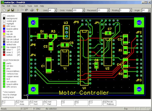

Finally, to take the netlist from KiCAD and layout the PCB, I've used FreePCB for a long time and had an excellent experience. It's a full-featured PCB layout program, all open-source. In the past few years FreePCB has added an autorouter, which I have yet to use but one of the engineers on my team gave it a go with good results.
Open-source electrical engineering design tools
Figure 3. FreePCB
