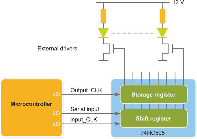

Figure 1 gives an example. A single 5 V 74HC595 shift register, with serial inputs and serial or parallel outputs, provides I/O expansion for the microcontroller. Serial data is applied to the serial input of the 74HC595 and clocked in via the input clock. Once the 74HC595 is loaded, the output clock applies the data to the storage register and to the parallel and serial outputs. External drivers, controlled by the 74HC595, then activate the corresponding LEDs.
Using Shift Registers to Reduce Size and BOM in LED Designs
Figure 1. An 8-bit 74HC595 shift register driving multiple LEDs.
Using the 7HC595 for I/O expansion means that it takes only three MCU control pins to drive up to eight LEDs. Reducing the number of control pins makes it possible to use an MCU with a lower pin count, and that can yield a smaller, more cost-effective design.

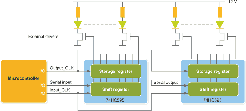

Also, because the 7HC595 includes a serial output, several devices can be cascaded together. Figure 2 gives the layout.
Figure 2. Cascading 74HC595 devices to drive more LEDs.
Now, with the cascading, the same three pins on the microcontroller can be used to control up to 16 or 24 LEDs instead of just eight. The ability to cascade shift registers can reduce the total number of microcontrollers needed in the design, and that can help lower costs and reduce size, too.

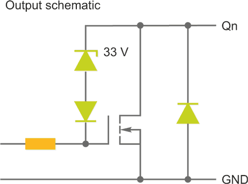

Figure 3 gives the output schematic for one such device, the NPIC6C596A LED driver from NXP, which combines shift register functions similar to a 74HC595 with a high-voltage (HV) MOSFET driver.
Figure 3. Output schematic for shift register
with open- drain outputs.

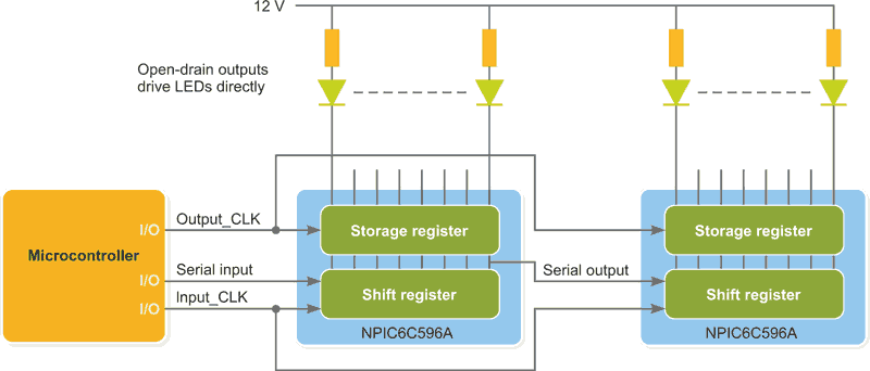

Replacing the 74HC595 with the NPIC6C596A eliminates the need for external drivers, creating a design that is more compact and has a lower bill of materials (Figure 4).
Figure 4. NPIC6C596A eliminates the need for external drivers.
NPIC6C devices have open-drain outputs that are tolerant to 33 V. Each output is designed to sink 100 mA and there is no limit on ground current. All the outputs can actively sink 100 mA simultaneously. The outputs include current-limiting circuitry, which sets a 250 mA maximum on the sinkable current, and each output also includes thermal protection. Having these protections means the NPIC6C496A device can be used to drive a wider range of LEDs than the 74HC595, including LEDs that operate at higher voltages and with higher forward current.

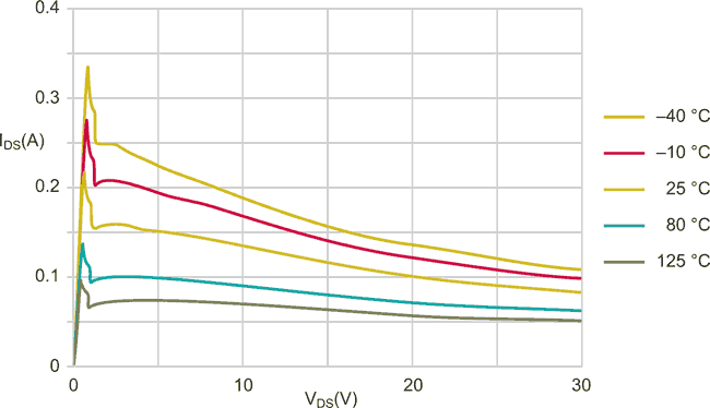

Figure 5 shows the behavior of the current-limiting circuitry on the open-drain outputs of the NPIC6496A. The circuitry limits the maximum current each output can sink. As the drain voltage increases, the drain source current decreases. This protects the outputs and the components they are driving. At 25 °C, the output clamp is typically activated when the drain source current is 250 mA.

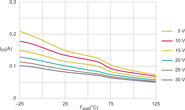

Figure 6 shows how the open-drain outputs of the NPIC6C596A provide thermal protection. The clamp current is inversely proportional to temperature. As the temperature increases, the output resistance increases, thus limiting the drain source current and preventing damage to the output and the components it drives. At 25 °C, the output typically limits the drain source current to 120 mA.
