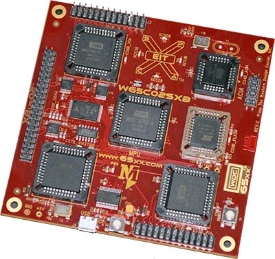

WDC sent me the W65C02SXB and the W65C816SXB, two single board computers based on the 65C02 and the 65C816, respectively.
Review: Single board 65C02 and 65C816 computers
There are hundreds of very well-documented designs floating around the Internet for 65xx-based computers, but most of these designs have a lot in common. If you’re looking to build your own 6502-based computer, you’ll need a CPU, some RAM, and an EEPROM or Flash chip. For peripherals, you’ll be looking at the 6520 PIA, a chip that provides two eight-bit ports of I/O, the 6522 VIA a more advanced I/O chip with timers and a shift register, and maybe an 6551 ACIA communications/serial chip if you’re a purist. This is the standard compliment of chips for a 6502-based computer, and if you believe [Chuck Peddle], the 6502 wasn’t that useful without these support chips.
Both the ’02 and ‘816-based single board computers from WDC feature an ACIA, a PIA, and two VIAs – the second VIA is connected to a microUSB interface designed for WDC’s Terbium IDE (TIDE). More on TIDE in a bit. Each board also has 32kB of SRAM and a 128kB Flash chip mapped into the top 32k of memory. This is a fairly standard layout for just about every homebrew 6502 computer, but there are a few features that make this board special. Every pin you would ever need – data, address, control, and some chip selects – are available on a header running the entire length of the board. This is great if you’d like to interface an SXB with some old hardware, but the potential for creating new hardware is interesting. When I talked to [David Cramer] and [David Gray] at WDC, we speculated on what interesting hardware could be made that supports this gigantic header. The board might be too big and cumbersome for a quadcopter, but a 3D printer controller board is entirely reasonable, and would probably work very well.

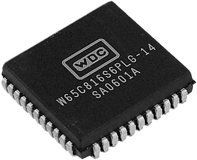

The Western Design Center doesn’t just deal with the 6502 and its support chips. It remains the only place where you can get the 65C816, a greatly expanded CPU built on the 6502 ISA.
The ‘816 is a very interesting chip, most famous for its use in the Apple IIgs and the Super Nintendo. With a 24-bit address bus, it supports 16 Megabytes of RAM, has 16-bit registers, and a few new instructions over the 6502. Most impressively, when you first turn a 65C816 on, it starts up in a 6502 emulation mode that is 100% compatible with the 6502 until you flip a bit in a ‘hidden’ register.
With new stack instructions and compatibility with the 65C02, you have to wonder what would have happened if the 65C816 were introduced a few years earlier. The chip was finished in 1984 in time for Apple to use it in the IIgs, and for [Bil Herd] to realize, ‘the reason to use it is because the competition is using it wasn’t going to be a successful pitch.’ A few years earlier, and this chip would have at least been considered in the initial designs of the Apple Lisa, Macintosh, the Atari ST line, and possibly even the IBM PC. It’s the greatest ‘what-ifs’ of computing history.
For the last 30 years, WDC have been the keepers of the 65C816 flame, and of course their educational offerings include a single board computer based around this chip. It is more or less identical to the W65C02SXB with PIA breakouts, VIA breakouts, and an ACIA breakout. The larger set of connectors contains all the data, address, and control lines of the XBus02 connector of the W65C02SXB, save for additional pins for the extra address lines.
Best of all, with a 65C816 development board, there’s no need to deal with the multiplexed data and address lines. Writing ‘816 code is as simple as plugging the board into your computer and mashing the keyboard; the Western Design Center has the only modern ‘816 C compiler, after all.

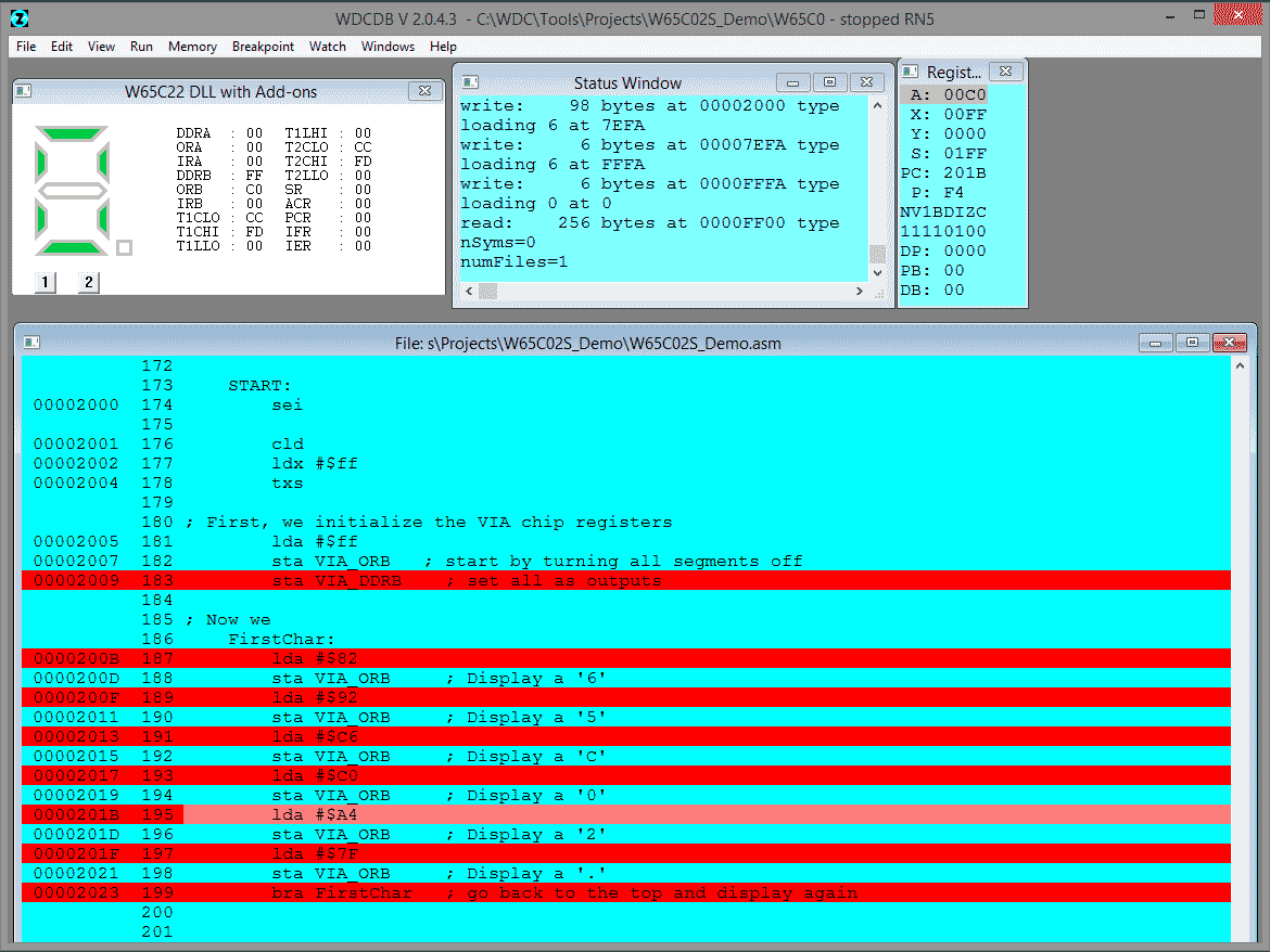

Aside from compiling and linking, TIDE also has another neat feature that’s directly applicable to the SXB boards: a simulator and debugger.
The addition of a simulator and debugger in TIDE is something you’re not going to get if you build your own 6502 single board computer. With the simulator and debugger, you can step into code, set breakpoints, and generally do everything you would expect to be able to do with an embedded IDE.
The sample project for the W65C02SXB was a ‘light up a seven segment display with a VIA’ tutorial, and this demonstrates the potential of the debugger; it even simulates the seven segment display with the help of a little code.
The TIDE simulator/debugger running the sample project with a
seven-segment display.

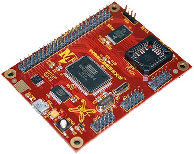

The Microcontroller Development Boards
WDC has not been resting on their laurels for 40 years. Their educational tools also include microcontrollers based on the 65C02 and 65C816. These are the W65C134SXB (based on the ’02, and was originally designed for life support), and the W65C265SXB (based on the 65C816).
Each of these boards feature the W65C134S or W65C256S microcontroller with 32kB of SRAM, a socket for a 32PLLC Flash ROM, one large connector that is more or less the same as their ‘full microprocessor’ counterparts, and three 10-pin connectors that are used for basic I/O, the Serial Interface Bus, and UART signals.
Although these microcontroller development boards appear very minimal – there are only four chips, a hand full of passives, and a bunch of pin headers, after all – appearances are deceiving. The microcontrollers are actually incredible pieces of engineering that really aren’t comparable to anything else on the market.

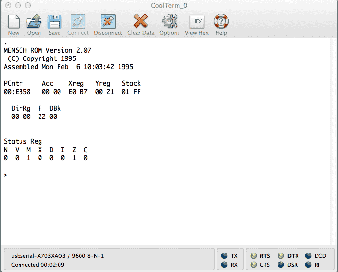

Inside both of these microcontrollers is a ROM monitor that functions just like any monitor program you’d find in an ancient computer. With this monitor, you can read and write to memory addresses, jump to addresses, and run code. All that’s needed is a USB cable, a terminal emulator (CoolTerm, Putty, a neat little Python script, or anything else that can connect to something over a serial port, 9600, 8N1) [Rod Biresch] has a great tutorial for entering opcodes into the ‘265SXB to blink an LED. Yes, it’s the most basic thing you can do with a microcontroller, but it does work, and can serve as the first stepping stone to more complex applications of an embedded 65xx ISA microcontroller.
The W65C265SXB ROM Monitor running in a terminal emulator.
Like their bigger brothers, they are also supported by the WDC’s own development environment, TIDE. With this, you can throw assembly or C at these little boards and they’ll chug right along.
