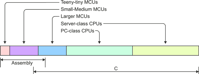

I feel like I've already set myself up for a sound shellacking with what I've written so far, so let's go for broke with a few images that depict the way I think of things and the way I think other people think of things, if you see what I mean. Let's start with the way I think of things prior to Python circa the late 1980s and early 1990s. At that time, I tended to visualize the programming landscape as looking something like the following:
Python is better than C! (Or is it the other way round?)
The way I used to think of things circa 1990 (Source: Max Maxfield / Embedded.com)
Again, I know that there were a lot of other languages around, but – for the purposes of this portion of our discussions – we're focusing on assembly language and C. At that time, a lot of embedded designers captured their code in assembly language. There were several reasons for this, not the least that many early MCU architectures were not geared up to obtaining optimum results from C compilers.

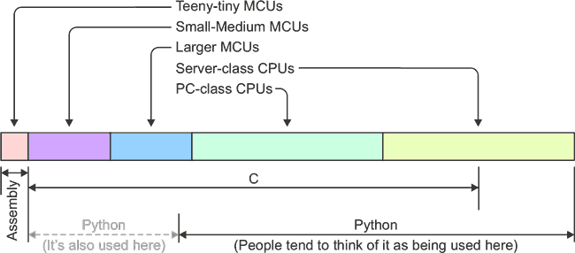

Next, let's turn our attention to today and consider the way I think other people tend to think of things today with respect to Python and C. Obviously processors have gotten bigger and faster across the board – plus we have multi-core processors and suchlike – but we're taking a "big picture" view here. As part of this, we might note that – generally speaking – assembly now tends to be used only in the smallest MCUs that contain only minuscule amounts of memory.
The way I think other people think of things circa 2016
In turn, this leads us to the fact that C is often described as being a low-level language. The term "low-level" may seem a bit disparaging, but – in computer science – it actually refers to a programming language that provides little or no abstraction from a computer's underlying hardware architecture. By comparison, Python is often said to be a high-level language, which means that it is abstracted from the nitty-gritty details of the underlying system.
Now, it's certainly true that the C model for pointers and memory and suchlike maps closely onto typical processor architectures. It's also true that – although it does support bitwise operations – pure Python doesn’t natively allow you to do things like peek and poke MCU registers and memory locations. Having said this, if you are using Python on a MCU, then there will also be a hardware abstraction layer (HAL) that provides an interface allowing the Python application to communicate directly with the underlying hardware.
