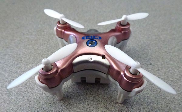

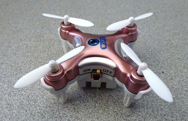

Here are four sequential quadrant views of the quadrotor, showing the power switch and charging port, camera, etc. (but perhaps obviously, no microSD slot this time):

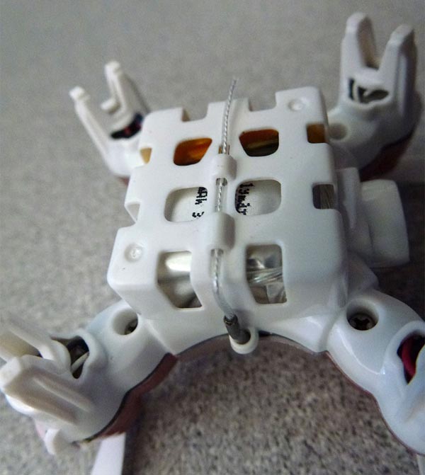

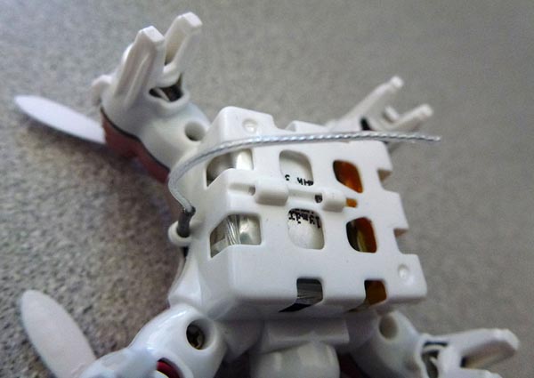

Look closely, and you'll peruse something we haven't seen before with either the CX-10 or CX-10C ... an external antenna. Here's a closeup, intact:
Teardown: Drone streams live video
And unfurled:
For reasons that will become clearer shortly, I'm pretty sure this one is for 2.4 GHz Wi-Fi.
