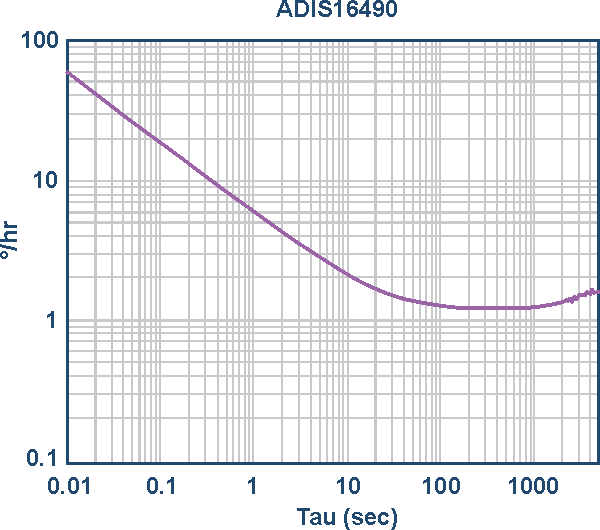

Figure 1. | ADIS16490 gyroscope root Allan variance. |
Of course, using a state-of-the-art IMU that has minimal bias instability within the design at the onset may offer the most immediate impact on gyroscope drift. The constant bias error of a gyroscope can be measured by taking the average of the output over a long period of time while the device is not rotating. An IMU Allan variance plot shows the gyroscope drift in rotational degrees per hour vs. the integration time, Tau. It is normally plotted on a log-log scale. The ADIS16490 is the latest product within ADI’s portfolio of high performance, tactical grade IMUs. The ADIS16490 has an in-run bias stability of merely 1.8° per hour. This is reflected on the ADIS16490 Allan variance plot in Figure 1, where 1.8° of error is seen at the one hour point (3600 seconds).
