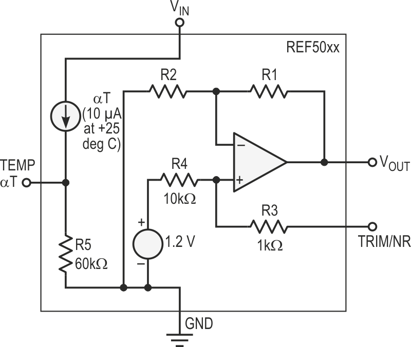

Texas Instruments’ REF50xx is a family of low-noise, low-drift, high precision series voltage references. Excellent temperature drift (3 ppm/°C) and high accuracy (0.05%) are achieved using proprietary design techniques.
Fig. 1 shows a simplified block diagram of the REF50xx family that provides a very accurate voltage output. However, VOUT can be adjusted to reduce noise and shift the output voltage from the nominal value by configuring the trim and noise reduction pin (TRIM/NR, pin 5). The TRIM/NR pin provides a ±15-mV adjustment of the device bandgap, which produces a ±15-mV change on the VOUT pin.
| Figure 1. | REF50xx references are capable of both sinking and sourcing, and are very robust with regard to line and load changes. |
A supply bypass capacitor ranging between 1 µF to 10 µF is recommended. A 1 µF to 50 µF, low-ESR output capacitor (CL) must be connected from VOUT to GND. It must be less than or equal to 1.5 Ω. The ESR minimizes gain peaking of the internal 1.2-V reference and thus the REF50xx allows access to the bandgap that reduces noise at the VOUT pin. Placing a capacitor from the TRIM/NR pin to GND in combination with the internal 1-kΩ resistor creates a low-pass filter that lowers the overall noise measured on the VOUT pin. A capacitance of 1 µF is suggested for a low-pass filter with a corner frequency of 14.5 Hz. Higher capacitance results in a lower cutoff frequency.
There are seven different output voltage versions providing 2.048, 2.5, 3.0, 4.096, 4.5, 5.0, and 10 V. Each reference voltage is available in both standard and high-grade versions. They are offered in SO-8 packages and are specified from –40 °C to +125 °C.
