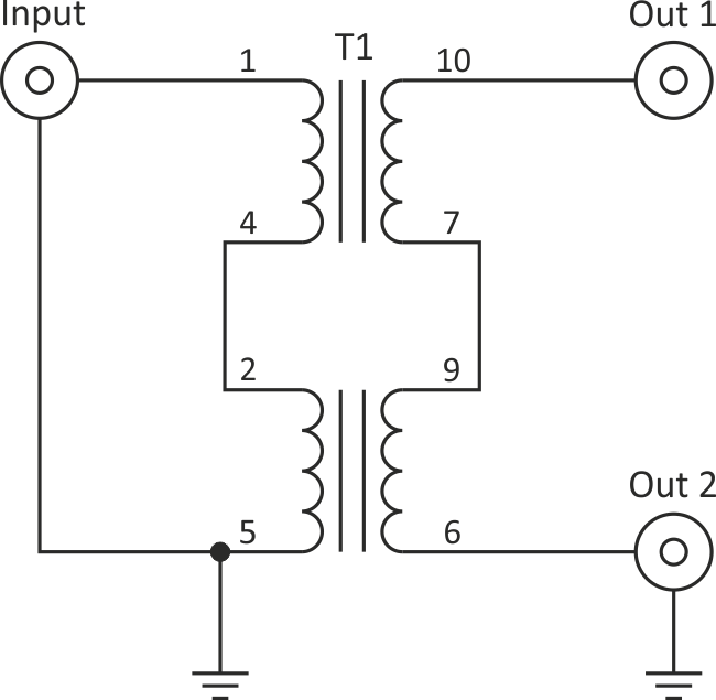

Figure 2. The differential circuit of Figure 1 requires a transformer. It is the least
expensive way of obtaining a differential output voltage from that circuit.

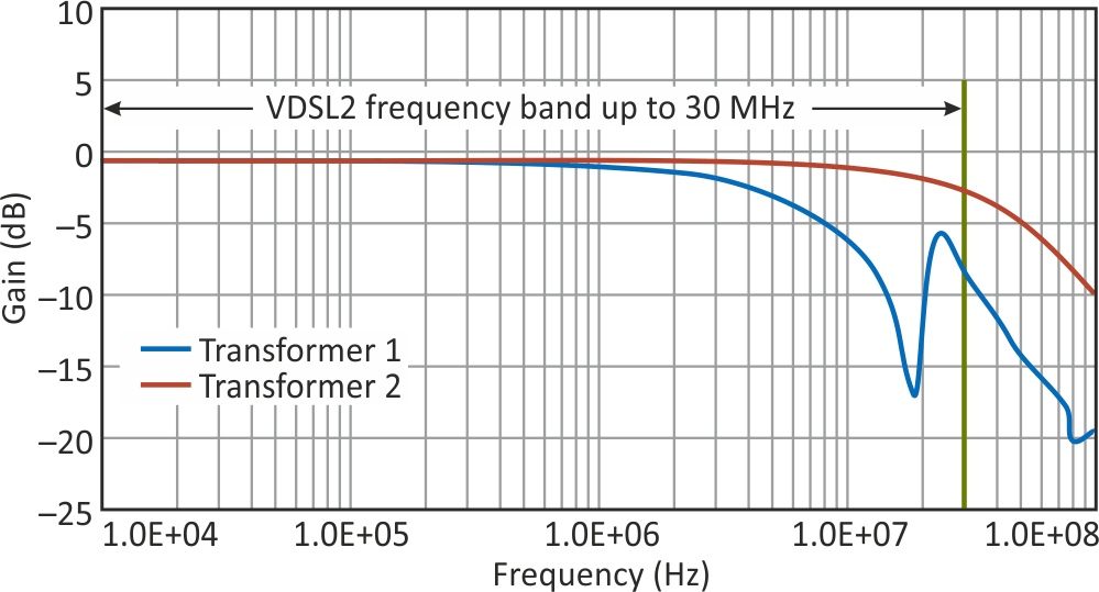

Using a transformer to generate a differential signal is the least expensive approach (Fig. 2). Measuring the transformer’s bandwidth is one important aspect, because we don’t want the setup to have less bandwidth than the amplifier. Figure 3 shows the frequency response of two transformers with different bandwidths. The curves show that only transformer 2 is capable of measuring an amplifier with a 30-MHz bandwidth, while transformer 1 is limited to 4 MHz. An alternate solution in generating a differential signal is to use signal splitters. The table presents the specifics of the transformer and splitter.

Figure 3. The choice of the correct transformer shown in Figure 2 is important to ensure
a proper frequency response when driving a pair of xDSL lines. Note that
transformer 2 has a better frequency response than transformer 1.
This is the common case of time versus money. If one can spare $60, I would recommend using a signal splitter as a source to generate a differential signal. A signal splitter can guarantee its bandwidth versus using a transformer where the user needs to verify the bandwidth. In either case, the one-output-port network analyzer can now have two output ports with the use of a transformer or a signal splitter.
