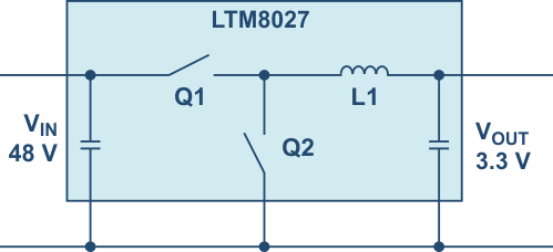

Figure 1. Conversion of a voltage from 48 V down to 3.3 V
in one single conversion step.

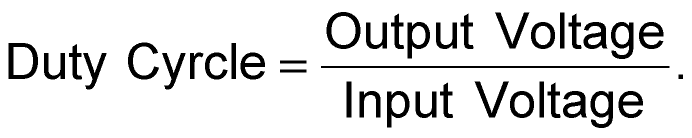

If a step-down converter (buck) is used for this single conversion step, as shown in Figure 1, the problem of small duty cycles emerges. The duty cycle is the relationship between the on-time (when the main switch is turned on) and the off-time (when the main switch is turned off). A buck converter has a duty cycle, which is defined by the following formula:
With an input voltage of 48 V and an output voltage of 3.3 V, the duty cycle is approximately 7%.
This means that at a switching frequency of 1 MHz (1000 ns per switching period), the Q1 switch is turned on for only 70 ns. Then, the Q1 switch is turned off for 930 ns and Q2 is turned on. For such a circuit, a switching regulator has to be chosen that allows for a minimum on-time of 70 ns or less. If such a component is selected, there is another challenge. Usually the very high power conversion efficiency of a buck regulator is reduced when operating at very short duty cycles. This is because there is only a very short time available to store energy in the inductor. The inductor needs to provide power for a long period during the off-time. This typically leads to very high peak currents in the circuit. To lower these currents, the inductance of L1 needs to be relatively large. This is due to the fact that during the on-time, a large voltage difference is applied across L1 in Figure 1.
In the example, we see about 44.7 V across the inductor during the on-time, 48 V on the switch-node side, and 3.3 V on the output side. The inductor current is calculated by the following formula:
If there is a high voltage across the inductor, the current rises during a fixed time period and at a fixed inductance. To reduce inductor peak currents, a higher inductance value needs to be selected. However, a higher value inductor adds to increased power losses. Under these voltage conditions, an efficient LTM8027 µModule® regulator from Analog Devices achieves power efficiency of only 80% at 4 A output current.
