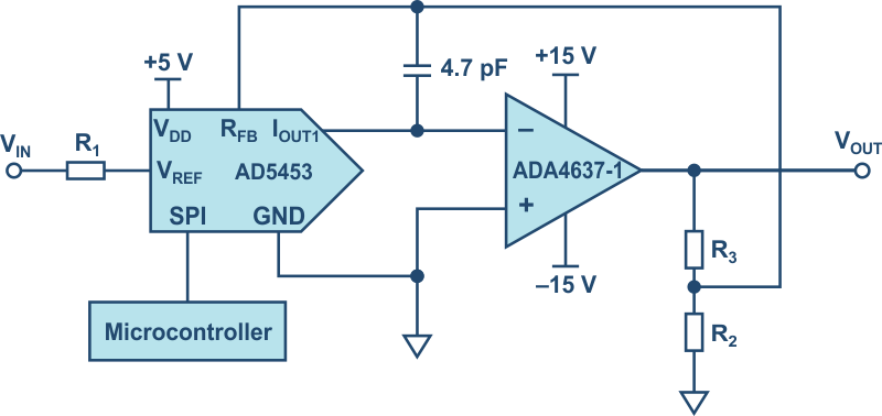

Figure 1 shows an AD5453 14-bit MDAC with a downstream amplifier that can amplify or weaken the signal based on the DAC’s programmed code.

Figure 1. Circuit with variable gain (PGA).

The output voltage is affected or bounded by the operational amplifier’s supply voltage, apart from the gain and the set code D of the DAC. In the case shown, the ADA4637-1 amplifier supplied with ±15 V should output a maximum voltage of ±12 V to leave it an adequately large control range. The gain is determined via the resistors R2 and R3:
All resistors (R1 to R3) should have the same temperature coefficient of resistance (TCR), which, however, does not have to be the same as the TCR of the DAC’s internal resistors. The resistor R1 is used to adjust the internal resistor (RFB) in the DAC to the resistors R2 and R3 according to the following relationships:
The resistors must be selected in such a way that the op amp is still within its operating range at the maximum input voltage (the DAC can handle ±10 V at VREF). It should also be noted that the amplifier’s input bias current (IBIAS) is multiplied by the resistance (RFB + R2 ‖ R3) and that this has a considerable effect on the offset voltage. For this reason, the ADA4637-1 op amp with a very low input bias current and a very low input offset voltage according to the data sheet that was selected. To prevent instabilities in the closed-loop control system or so-called ringing, the 4.7 pF capacitor was inserted between IOUT1 and RFB; this is especially recommended for fast amplifiers.
