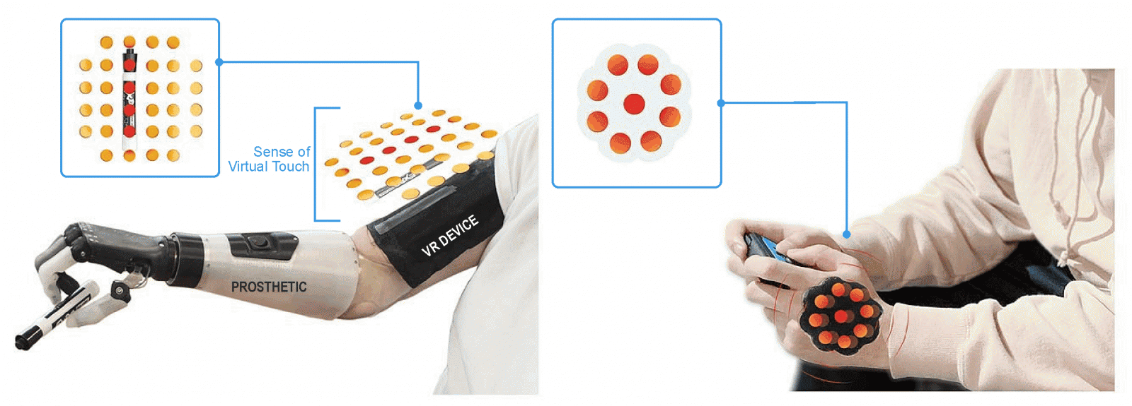

This team has developed an actuator that receives its inputs wirelessly and then simulates “touch” with vibration created by a thin, soft, and adhesive bandage-like device on the skin.
Based on structural mechanics, the pad is comprised of hundreds of functional components, including actuators simulating touch by millimeter-scale mechanical vibration. These components are attached to a thin silicone-coated elastomeric layer about 3-mm thick. The pad is breathable, reusable, and can remain attached and working despite the user going through a full range of bending and twisting motions. More importantly, a collection of circuits and antennae embedded in the pad lets it be powered and controlled wirelessly.
Wearable Haptic Device Creates the Sensation of Touch
The newly developed system of “skin-integrated haptic interfaces” can help users of prosthesis to feel the surrounding
environment and be used for social media, entertainment and gaming. City University of Hong Kong
The haptic actuators harvest radio frequency power through the large, flexible antenna within a certain distance, so the user wearing the device can move freely without the trouble of wires. The system works when within about three feet of the transmitter, which might not sound far, but it is 10 times the maximum distance of similar technologies.
The haptic actuators require less than 2 milliwatts to create induce a notable sensation, while conventional DC-driven alternatives ones need about 100 milliwatts to produce the same level of vibration.
