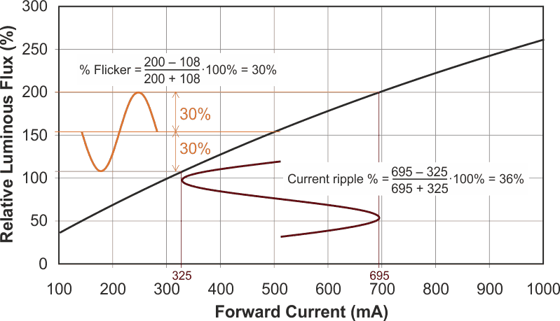

Light flicker in LED lamps is caused by the varying current that passes through the LED string. The relation of luminous flux versus current is not entirely linear; it depends on the LED string characteristic as shown in figure 1.
The luminous flux of the LED string vs. current.
Figure 1. The luminous flux of the LED string vs. current.
Measuring the varying current in the LED string is therefore not as accurate as measuring the actual light.

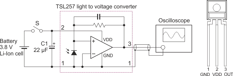

The schematic in figure 3 shows a simple light to voltage converter using the TSL257 IC.
Light to voltage converter circuit based on TSL257.
Figure 3. Light to voltage converter circuit based on TSL257.
The TSL257 is a simple light to voltage converter IC with good linearity. It can be powered from a single Li-Ion cell, making it a portable measurement tool. The output voltage is directly proportional to the light intensity (irradiation) and can be connected to an oscilloscope, thereby showing the light fluctuation as a waveform on the scope screen. The 2 kHz bandwidth is sufficient for light flicker measurements. TSL257 is not expensive, and can be bought at Farnell or Digikey.

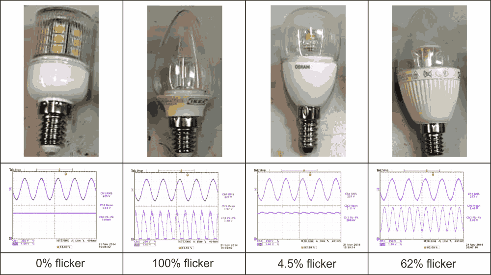

Figure 5 shows some examples of flicker measurements of LED candle lamps. The blue waveform is the mains voltage and the purple waveform is the measured light intensity. As can be seen, the light flicker can vary considerably over different lamps.
LED candle lamps flicker measurement examples
Figure 5. LED candle lamps flicker measurement examples.
0% flicker
100% flicker
4.5% flicker
​62% flicker
