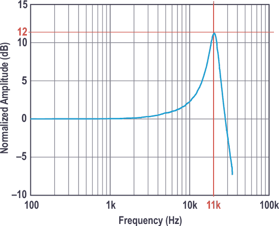

Frequency Response
The frequency response of the accelerometer is the most important characteristic of the system and is shown in Figure 2. The gain increases at frequencies above about 2 kHz to 3 kHz. For the resonant frequency (11 kHz), a peak value for the gain of about 12 dB (factor of 4) in the output voltage is yielded.
Frequency response of the ADXL1002.
Figure 2. Frequency response of the ADXL1002.
