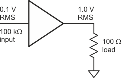

Ignoring that R1/R2 term can lead to serious confusion, so caution is in order. As an example, let’s consider Figure 1, which shows an amplifier with a high input impedance (R1, 100 kΩ) and a low output impedance driving a load impedance of 100 Ω (R2). The input voltage is 0.1 VRMS and the output voltage is 1 VRMS, for a voltage gain of 10. In decibels, the voltage gain is 20log(10) = 20 dB.
An amplifier with 100 kΩ input impedance drives a 100 Ω load.
Figure 1. An amplifier with 100 kΩ input impedance drives a 100 Ω load.
Now let’s look at the power situation. The input power is (0.1)2/100 k = 0.1 µW, while the power delivered to the load is (1.0)2/100 = 10 mW. Using the power values to calculate the gain, we get 10log(10 mW/0.1 µW) = 50 dB. That causes a different amplifier gain in dB depending on whether we use voltage or power. The decibel formula for voltage ratios was derived from the power formula, so we would expect them to be consistent.
