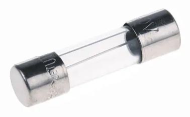

Among the most widely-used fuse body sizes is the 3AG size, measuring 6.3×32 mm, which is available in standard ratings from 100 mA to 15 A, in fast-acting, slow-blow, precision, and time-delay versions. It usually has a clear glass enclosure (Figure 1).
| Figure 1. | The glass-body 3AG fuse is among the most widely-used in older consumer products as well as older and current chassis-based instrumentation and equipment. Source: Codrey Electronics |

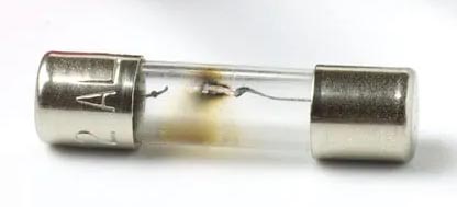

Shatter-proof ceramic ones are also available, but one of the handy features of the glass-body version is that you can tell at a glance if it has been blown (Figure 2).
| Figure 2. | It’s easy to check the status of the glass-body 3AG fuse. Source: Codrey Electronics |
Among the many attributes of the 3AG fuse is that it fits into a fuseholder socket and can be removed, inspected, and replaced without tools in a few seconds. Of course, that convenience can lead users to sometimes change it without first finding out why it need replacing: was it due to an eternal surge or because of an internal short circuit?

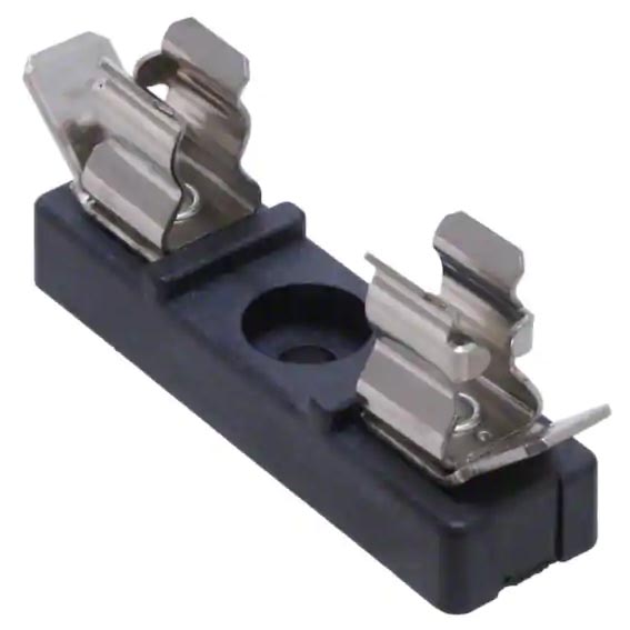

| Figure 3. | This fuseholder is designed to be screwed to a mounting surface, and the wires are either connected using slip-on contacts or soldered. Source: Keystone Electronics via Digi-Key |

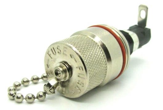

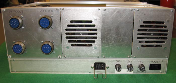

The 3AG fuse is supported by a large number of fuseholders, including PCB surface-mount units, discrete-wire models (Figure 3), as well as the very popular panel-mount version often used on the back of a chassis (Figure 4). There are even RFI-shielded holders with a captive cap for applications where you don’t want to lose the cap, which is part of the fuse circuit path (Figure 5).
| Figure 4. | The panel-mount fuseholder is widely used on chassis, most often on the back panel; this spectrograph project uses one fuse and holder for each of its three independent power rails. Source: University of California Observatories |
| Figure 5. | For rugged applications, this metal 3AG holder has a captive cap, which also maintains chassis EMI/RFI shielding integrity. Source: eBay |

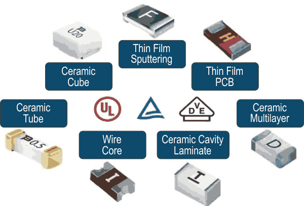

For example, Bourns has the SinglFuse product portfolio, which comprises seven different fuse-construction technologies: thin-film sputtering, thin-film PCB, ceramic multilayer, ceramic cavity laminate, wire core, ceramic tube, and ceramic cube (Figure 6).
| Figure 6. | It takes a variety of underlying technologies to create surface-mount, regulatory-approved fuses that can handle currents across a wide range. Source: Bourns via Digi-Key |
The package sizes of these thermal devices range from an almost invisible 0402 – 0.040×0.020 inch or 1.0×0.5 mm – at the lower current ranges to 3812 – 0.150×0.100 inch or 3.81×2.54 mm – at current ratings of 62 mA to 100 A. Despite their diminutive size, they are UL/CSA/IEC approved, and some models are also AEC-Q200 qualified for automotive use.
