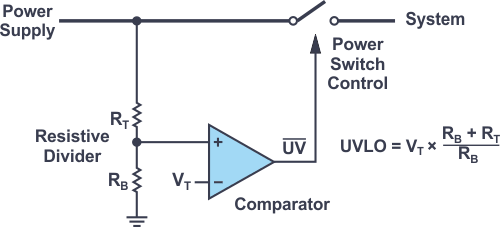

Figure 1 shows an undervoltage lockout circuit (without hysteresis for now). It has a comparator with a positive reference voltage (VT) at its negative input. The comparator controls a power switch that opens or closes the path between the power supply input and the downstream electronic system. The comparator’s positive input connects to a resistive divider from the input. If the supply is turned on and starts rising from 0 V, the comparator output is initially low, keeping the power switch off. The comparator output trips when its positive input reaches VT. At this moment, the current in the bottom resistor is VT/RB. The same current flows in RT if the comparator has no input bias current. Therefore, the supply voltage when the comparator trips is
This is the supply UVLO threshold set up by the resistive divider. For example, a VT of 1 V and RT = 10 × RB yields a UVLO threshold of 11 V. Below this threshold, the comparator output is low, opening the power switch; above this UVLO threshold, the switch is closed and the supply flows through to power up the system. The threshold can be easily adjusted by changing the ratio of RB and RT. The absolute resistor value is set by the amount of bias current budgeted for the divider (more on this later). To set up an OVLO threshold, just swap the two inputs of the comparator (for example, see the lower comparator in Figure 2) such that a high going input forces the comparator output low and opens the switch.

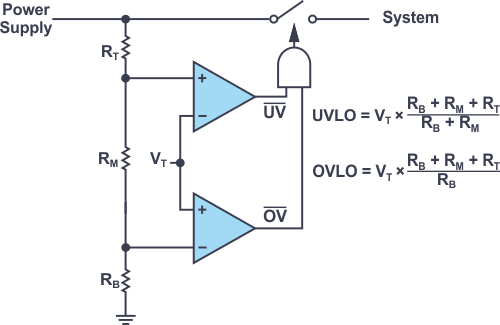

Getting back to resistive dividers: a 3-resistor string sets up both undervoltage and overvoltage lockout thresholds (Figure 2), saving one divider’s bias current vs. using two separate 2-resistor strings. The UVLO threshold is
while the OVLO threshold is
An AND gate combines the output of the two comparators before sending it to the power switch. Therefore, the power switch closes to power the system when the input voltage is between the undervoltage and overvoltage thresholds; otherwise, the switch is open, disconnecting the supply from the system. If divider current consumption is not a concern, separate undervoltage and overvoltage dividers provide more flexibility in adjusting each threshold independently of the other.

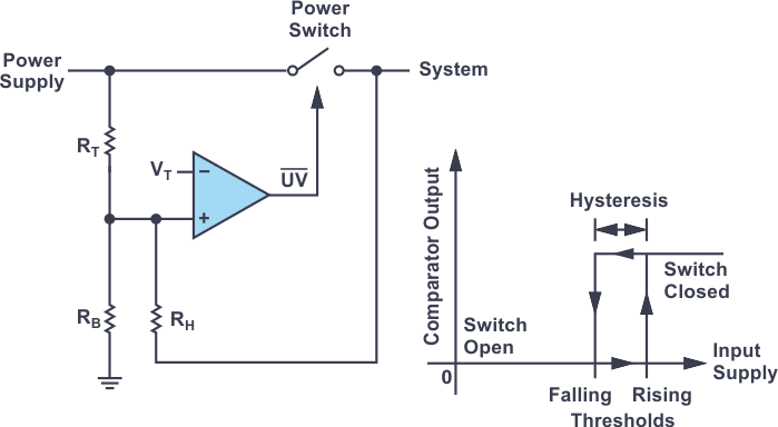

Resistor from Divider to Output (Figure 3):
Adding undervoltage lockout threshold hysteresis with a resistor from the divider tap to the power switch output.
Figure 3. Adding undervoltage lockout threshold hysteresis with a resistor from the divider tap
Add a resistor (RH) from the divider tap (the comparator’s positive input) to the power switch output. When the supply starts rising from 0 V, the comparator’s positive input is below VT and the comparator output is low, keeping the power switch off. Assume that the switch output is at 0 V due to the system load. Hence, RH is in parallel with RB for input threshold calculation. The rising input undervoltage threshold is
where
The switch turns on above this threshold, connecting the supply to the system. To calculate the falling input undervoltage threshold, RH is in parallel with RT since the switch is closed, giving the falling input undervoltage threshold as:
where
If the comparator itself had some hysteresis, substitute VT with the rising or falling comparator threshold in the previous equations. Recall the Figure 1 example, with VT = 1 V and RT = 10 × RB, where both the rising and falling thresholds are 11 V in the absence of comparator hysteresis or RH. Adding an RH = 100 × RB, as in Figure 3, gives a rising input threshold of 11.1 V and a falling threshold of 10.09 V; that is, a hysteresis of 1.01 V. This method does not work for OVLO because a rising input turns off the power switch, causing RH to pull the comparator input lower (which turns on the switch again) instead of higher.

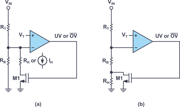

Switching in a Resistor (Figure 4):
Adding undervoltage or overvoltage lockout threshold hysteresis with a switched (a) shunt resistor or current and (b) a series resistor.
Figure 4. Adding undervoltage or overvoltage lockout threshold hysteresis with a switched (a)
Another method of adding hysteresis is to switch in a resistor that changes the effective value of the bottom resistor. The switched resistor can be in parallel (Figure 4a) or in series (Figure 4b). Consider Figure 4a: when VIN is low – say, 0 V – the comparator’s output (UV or OV node) is high, turning on the N-channel MOSFET M1 and connecting RH in parallel with RB. Assume that M1’s on-resistance is either negligible compared to RH or is included in RH’s value. The rising input threshold is the same as in Figure 3:
Once VIN is above this threshold, the comparator output is low, turning off M1 and disconnecting RH from the divider. Therefore, the falling input threshold is the same as in Figure 1:
Continuing our example with VT = 1 V, RT = 10 × RB, and RH = 100 × RB, the rising input threshold is 11.1 V and the falling threshold is 11 V; that is, RH yields a hysteresis of 100 mV. This and the following methods can be used for either undervoltage or overvoltage lockout as their purpose depends on how the comparator output turns on the power switch (not shown).
The configuration of Figure 4b gives the rising input threshold as
and the falling input threshold as
RH = RB/10 in Figure 4, giving 11 V as the rising input threshold and 10.091 V as the falling threshold – that is, 909 mV of hysteresis. This shows that the Figure 4b configuration needs a much smaller RH to yield a much larger hysteresis.
Switching in a Current (Figure 4a):
The resistor RH of Figure 4a can be replaced by a current source IH. This method is used in the LTC4417 and LTC4418 prioritized controllers. When VIN is low, the comparator’s high output enables IH. At the rising input threshold, the negative input of the comparator is at VT. Therefore, the current in RT is
yielding the rising threshold as
Once VIN is above this threshold, IH is turned off by the comparator’s low output. Therefore, the falling threshold is the same as in Figure 1:
and the input threshold hysteresis is IH × RT.
