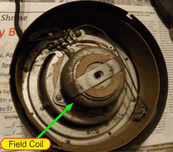

Since the field coil doubled in service as a power supply filter choke, current passing through that coil carried a ripple current, 120 Hz in the case of a 60 Hz power line, and that ripple current would produce a low but discernible level of hum in the audio output.
This vintage field coil speaker photo was posted on eBay.
Figure 2. This vintage field coil speaker photo was posted on eBay.
The hum was low enough to be pretty much acceptable to most listeners but as permanent magnet technology matured so that such magnets became stronger and less costly, field coils were pretty much done away with in consumer products in favor of using permanent magnets.
