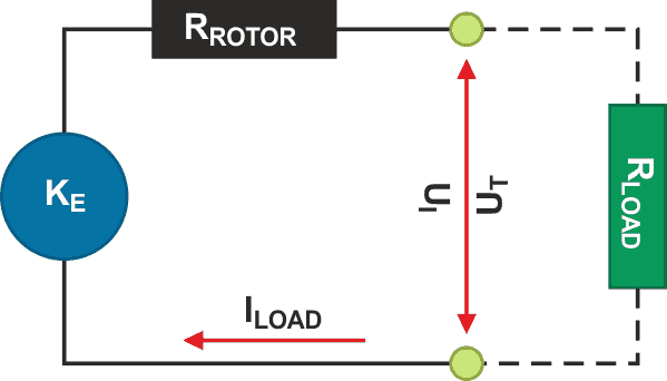

The graph in Figure 1 shows that the voltage generated across the motor’s terminals (UT) is directly proportional to the angular speed of the rotor when the load (RLOAD) is not connected across the terminals. In this condition, the current through the motor is zero. When a load is connected across the motor terminal, current flows and the voltage is reduced depending on the total load resistance. The terminal voltage (UT) when the load is connected and current (ILOAD) is flowing through the circuit is given as:
  (2)
or
  (3)
where
  (4)
As the load current increases for a fixed angular speed of the motor shaft, the terminal voltage decreases. When the back EMF equals the resistive voltage drop across the terminals, the terminal voltage becomes zero.
Equivalent circuit of a DC motor as a generator.
Figure 1. Equivalent circuit of a DC motor as a generator.

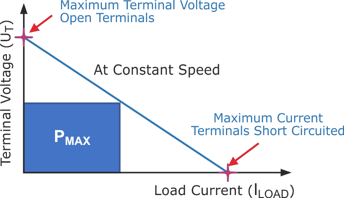

The graph in Figure 2 charts the load current versus terminal voltage of an ideal brushed DC motor used as a generator. When motor terminals are not connected, UT equals UI, and current does not flow through the rotor windings. When the terminals are short-circuited, the maximum amount of current flows through the circuit and UT becomes zero.
Load current versus terminal voltage.
Figure 2. Load current versus terminal voltage.
The maximum current through the circuit can be calculated as:
  (5)
With all other parameters held constant, as the motor shaft’s angular speed increases, the graph shifts right with same slope, increasing both UI and IMAX. In the above equation, the motor windings’ inherent resistance (RROTOR) is the limiting factor for the generator mode’s maximum current. If RROTOR is high, the generator’s sensitivity increases and the resulting voltage varies with current drawn creates, creating an unstable system. A motor with a higher back EMF constant and lower resistance, however, provides stable operation.

The electrical output power at any load current and terminal voltage can be represented by the rectangular area under the slope as shown in Figure 2.
  (8)
Output power maxes out when UT is half of the UI. At this point, the load current ILOAD is half of the maximum current IMAX. Therefore,
  (9)
A motor used for a generator should not be chosen solely on power considerations. Ideally, PMAX should always be higher than the generator’s required electrical output power. Depending on the load current value, the load point on the Figure 2 graph can move along the x-axis. Thus, the actual power output (PACTUAL), may be less than PMAX. While selecting the right motor to be used as a generator, PACTUAL should be taken into consideration and not PMAX. This may require selecting a motor with a higher rating.

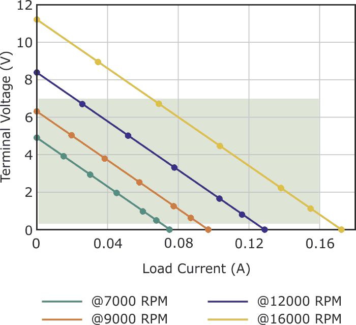

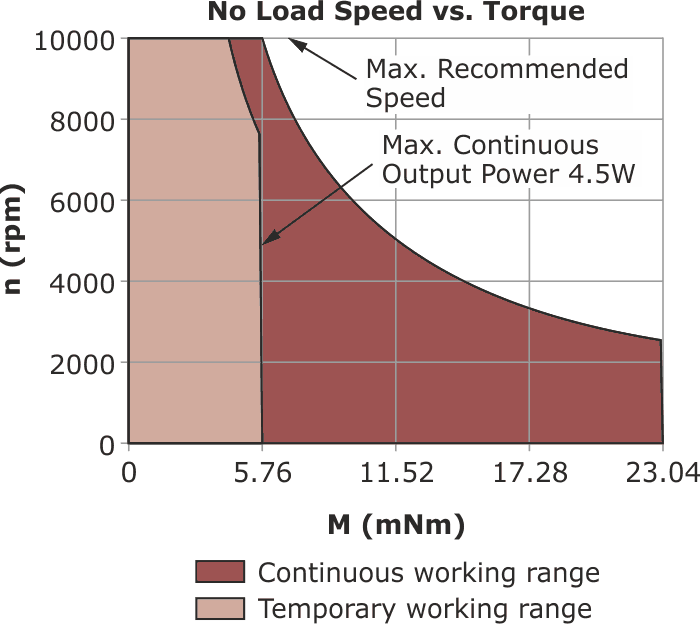

The output characteristics for 16C18 at different shaft speed is plotted in Figure 4.
Working range of Portescap 17 DCT motor.
Figure 4. Working range of Portescap 17 DCT motor.
The shaded box in the graph above is the area of continuous operation. For intermittent operations, various factors such as maximum temperature rise, maximum shaft speed, the motor’s mechanical limit, and generator life should be considered.

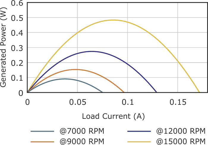

Output power characteristics of 16C18.
Figure 5. Output power characteristics of 16C18.

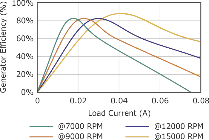

The graphs in Figures 5 and 6 show that the 16C18’s efficiency is relatively higher at lower generator current. At maximum output power, the output efficiency is close to 50%. It is ideal to select a generator with a working point close to the maximum efficiency.
Efficiency characteristics of 16C18.
Figure 6. Efficiency characteristics of 16C18.
This ensures system losses are minimized and less mechanical input power is needed to generate the desired output voltage and-current characteristics.
It is often misunderstood that a brushed DC motor running in generating mode is not as efficient as when functioning as a motor. However, using the proper motor, loads and operating speed will yield reasonably high efficiencies. The electrical and mechanical factors must always be considered when determining operating points.
