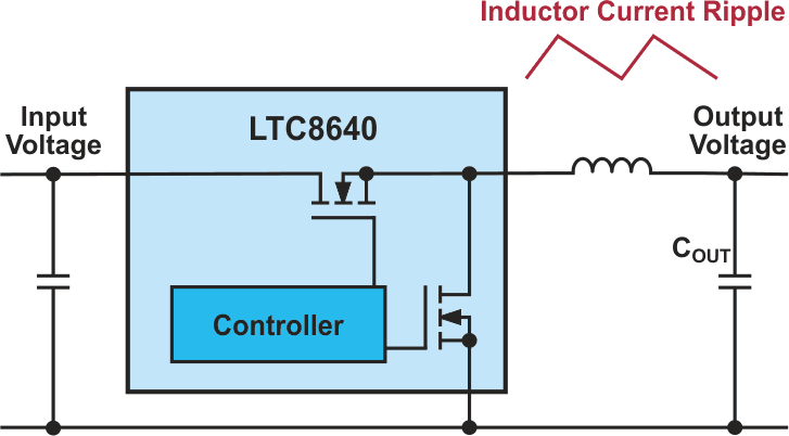

| Figure 1. | A buck converter with an inductor current ripple. |
For a buck converter such as the one shown in Figure 1, Equation 1 applies:
			(1) |
This equation calculates the required inductor value L for a buck converter based on the current ripple ratio CR. This ratio is usually specified as 0.3, or 30%, peak-to-peak ripple. Here, D is the duty cycle and T is the cycle time, which depends on the respective switching frequency.

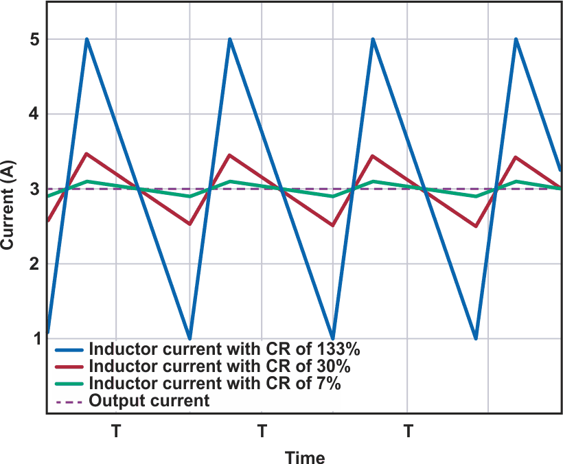

Figure 2 shows the inductor current ripple (current ripple ratio (CR)) of 30% in a circuit with an output current of 3 A in red. This is the compromise that is usually selected in switching regulator circuit designs. The waveform shown in blue has an inductor current ripple of 133%, and the waveform shown in green has an inductor current ripple of 7%.

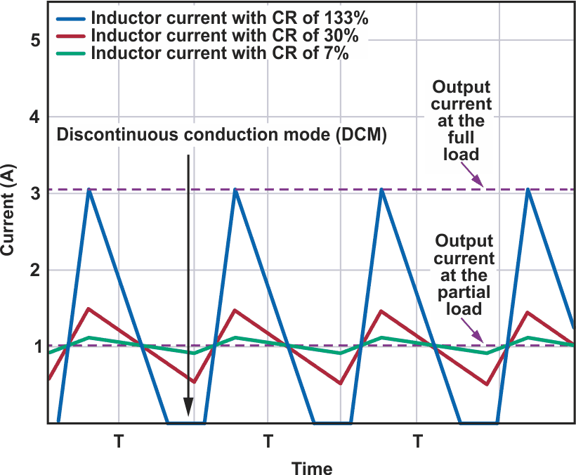

Figure 3 shows what happens when the same circuit is operated with part of the nominal load as the output current such as 1 A. At a high inductor current ripple, shown by the blue line in Figure 3, the energy in the inductor is completely discharged in every cycle. This mode is called discontinuous conduction mode (DCM). In this mode, the control loop stability behavior changes and a higher output voltage ripple can occur.
| Figure 3. | An inductor current ripple with a ripple current ratio of 30% shown in red, with a small inductor in blue, and with a large inductor in green at the partial load.  |
A certain ripple current ratio is needed in order for DCM to be avoided. With a ripple current ratio of 30%, a good compromise is achieved. If the ripple current ratio is low, even at partial loads, the system is mainly operating in continuous current conduction mode. The circuit can thus be optimized for operation in this mode.

At high ripple current ratios of greater than 30%, the inductor is smaller and thus cheaper. Unfortunately, the peak currents increase dramatically and generate more electromagnetic interference (EMI) than is absolutely necessary in a typical circuit. In addition, continuous conduction mode (CCM) can only be reached at higher load currents. This does not have to be a problem, but the operating behavior in this mode is changed and must be taken into account in the circuit design.
Higher output voltage ripple than for a lower inductor current ripple also result.
What if the effects of selecting a ripple current ratio that is too low?
For low ripple current ratios of less than 30%, the inductor is large and accordingly expensive. The load transient response is also slower due to the large size of the energy storage device. If, for example, a high load current is disconnected rapidly, the energy stored in the inductor has to go somewhere. This increases the voltage across the output capacitor (COUT). The more energy in the inductor, the higher the output voltage excess. This excess voltage can damage the supplied circuit.
