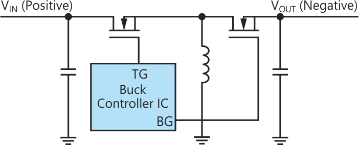

The inverting buck-boost topology is one of the basic switching regulator topologies, requiring just one inductor, two capacitors, and two MOSFETs as switches. The switches can be driven with any buck regulator or controller. The availability of possible switching regulator building blocks is therefore large. Figure 1 shows the inverting topology with all the necessary components.
| Figure 1. | An inverting buck-boost topology for generating a negative voltage with a step-down (buck) switching regulator. |

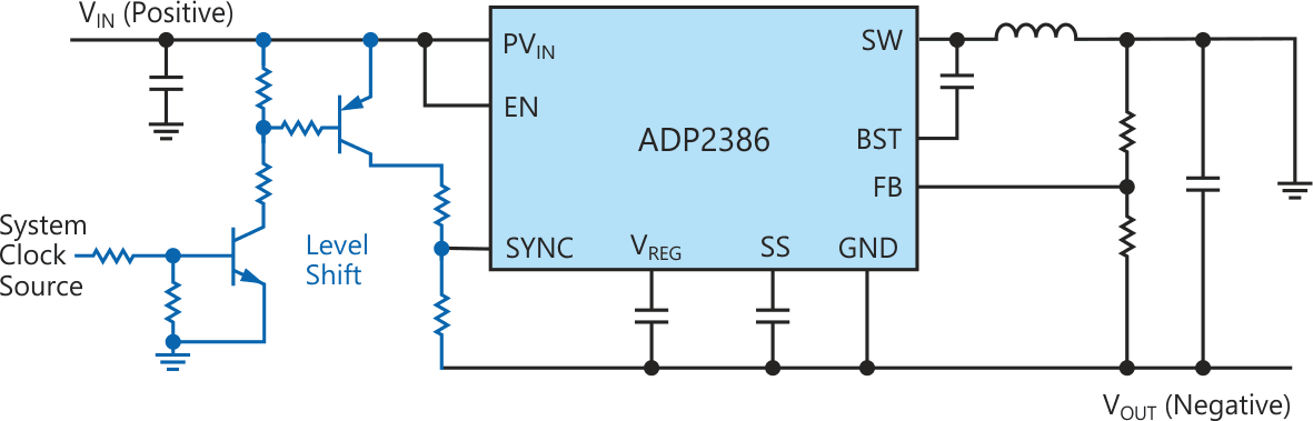

Figure 2 shows a buck-boost circuit with an ADP2386 buck regulator. If a buck regulator IC is used for the inverting circuit, the ground connection of the IC is at the generated negative voltage. The original output voltage from the buck regulator is connected to the system ground. The buck regulator in the inverting topology references its own ground to the set negative voltage because the output voltage is connected to the system ground. The reference ground for the IC (GND in Figure 2) is not connected to the system ground. As a result, these two grounds are not at the same potential. The switching regulator IC ground becomes the generated negative voltage. All pins on the switching regulator IC are now referenced to the generated negative voltage, rather than to the system ground. As a result, the communication lines and connections from the system to the IC and vice versa need level shifting to guarantee safe communication and prevent damage. Typically, the relevant signals are SYNC, PGOOD, TRACKING, MODE, EN, UVLO, and RESET.
| Figure 2. | External level shifter for supplying the switching regulator IC with an external clock for synchronization. |
Figure 2 shows a possible level shift circuit with two bipolar transistors and seven resistors (in blue) for one signal. This circuit requires a certain amount of space and adds complexity to the circuitry as well as costs. Such a level shifter would have to be implemented separately for all signals previously mentioned. It is especially complicated when a switching regulator IC uses a digital bus such as the Power Management Bus (PMBus). Then, the entire bus connection has to be operated with level shifting or galvanic isolation.

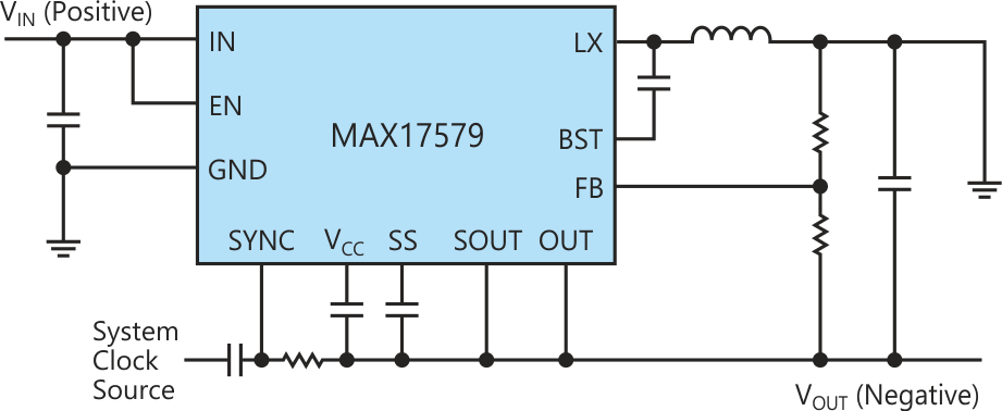

One way to avoid this external circuitry is to use a switching regulator IC that has been designed specifically for inverting voltages. Analog Devices offers a family of switching regulator ICs that are variations of buck regulator ICs. They are designed to facilitate communication between the system, that is, the entire electronic circuitry, and the inverting switching regulator IC. External level shifting as shown in Figure 2 is not needed.
Figure 3 shows the MAX17579 switching regulator IC, which generates a negative voltage from a positive voltage. As can be seen in Figure 3, the circuit is much more compact than the one in Figure 2.
| Figure 3. | A MAX17579 designed as an inverting buck-boost regulator and with level shifting already integrated. |
