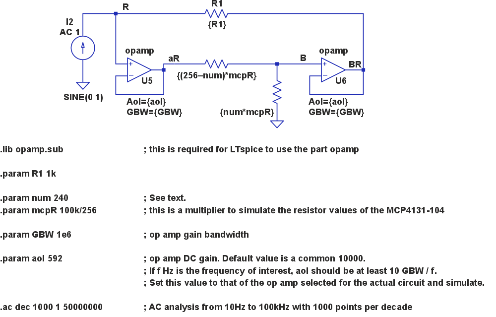

LTspice offers a user-specifiable op-amp called… well, “opamp”. It can be configured for user-selected values of a0L and GBW. The tool is configured as shown in Figure 3 to solve this problem.
LTspice can be used to determine op-amp requirements for an AC signal application.
Figure 3. LTspice can be used to determine op-amp requirements for an AC signal application.
The a0L value required for AC signals will be larger than that calculated in equation (3). It’s suggested to start with an a0L default value of 10000 (100 dB) and try different values of GBW. Use the results to select an op amp for the actual circuit and either simulate it if a model exists or at least update the simulation with the minimum specified values of a0L and GBW for the selected op amp.
Table 1 shows some examples of the behaviors of the circuit with different idealized op-amps. It’s clear that DC performance in either circuit is not a challenge for almost any op-amp. But it’s also evident that the AC performance of a given op-amp is notably better in the Figure 2 circuit than in that of Figure 1, and that a given error can be achieved with a lower performance and less costly op-amp in the Figure 2 circuit.
