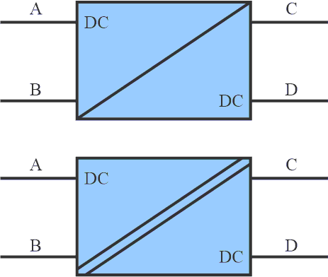

For circuit designers, a power supply is often considered a black box, or a 4-pole element. It has two input lines and two output lines. Figure 1 shows a symbol for a block diagram of a dc-to-dc converter. A dc-to-dc converter that is not galvanically isolated is shown at the top, and a galvanically isolated converter is shown at the bottom of the figure.
A switch-mode power supply shown as a black box.
Figure 1. A switch-mode power supply shown as a black box.

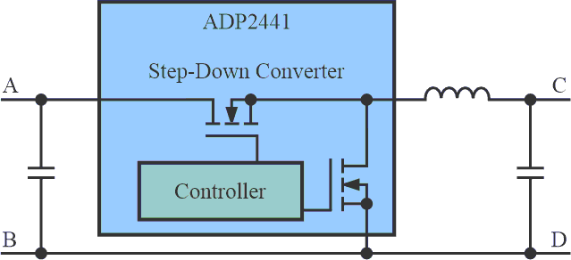

In Figure 1, noise information is not conveyed, with respect to the terminals. Different switching regulator topologies have different behavior in terms of the terminals of the 2-port network. Figure 2 shows a universal step-down converter, the ADP2441 from Analog Devices, for industrial applications. It converts 24 V at the input to 3.3 V at the output. With this topology, it can be seen that the input side generates pulsed currents and thus is very noisy. When the high-side switch on the ADP2441 is on, current flows into terminal A. When this switch is off, no current flows through node A. On the output side C, however, there is very little noise. Here, an inductor in the output path ensures that there is no pulsed current on the output side.
Practical design of a switching regulator topology.
Figure 2. Practical design of a switching regulator topology.
