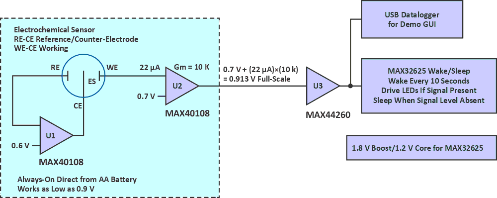

Figure 1 shows the block diagram of an electrochemical sensor such as ethanol or CO. The system consists of a low voltage op amp that operates directly from a 1.5 V AA/AAA battery, providing bias current to the electrochemical sensor while the rest of the system is in sleep mode to save power consumption. The first op amp, U1, powers the electrochemical cell’s reference electrode. The second op amp, U2, is configured as a transconductance amplifier, converting the sensor’s current output to voltage output to be digitized by a microcontroller after being amplified. This is done by the MAX44260, U3, which is a 1.8 V, 15 MHz low offset, low power, rail-to-rail input/output (I/O) op amp. ES is the electrochemical sensor.
A MAX40108 block diagram of an electrochemical sensor.
Figure 1. A MAX40108 block diagram of an electrochemical sensor.

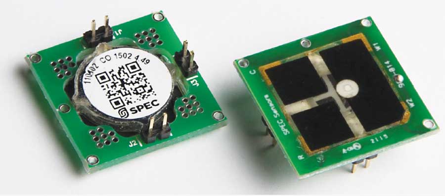

In this ethanol sensor evaluation, the sensor used is the SPEC 3SP_Ethanol_1000 package 110-202 shown in Figure 2.
The ethanol sensor SPEC 3SP_Ethanol_1000 package 110-202.
Figure 2. The ethanol sensor SPEC 3SP_Ethanol_1000 package 110-202.
This SPEC ethanol sensor generates a current proportional to the volume of the captured gas. It is a three-electrode device: WE, RE, and CE.
  • WE: Working electrode. This WE is biased at 0.7 V and used for sensing the gas vapor.
  • RE: Reference electrode. This RE provides a stable electrochemical potential of 0.6 V bias voltage in the electrolyte, which is not exposed to the gas vapor.
  • CE: Counter electrode (CE). The CE conducts when a gas is present. The level of conduction is proportional to the concentration of gas, which can then be electrically measured by the system.
In this gas sensor evaluation, the gas particles need to be physically in contact with the SPEC sensor. In other words, the ethanol sensor is basically measuring only the gas that is present at the exact location of the sensor itself. Therefore, to detect gases such as ethanol and CO accurately and effectively, place the sensors where the concentration of gas is expected to diffuse to the location. In this experiment, a cotton swab was dipped in an ethanol solution and placed right in front of the SPEC sensor.

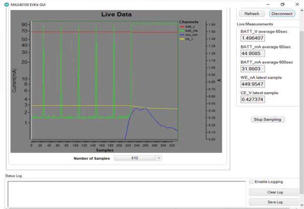

Performance of the ethanol sensor.
Figure 3. Performance of the ethanol sensor.

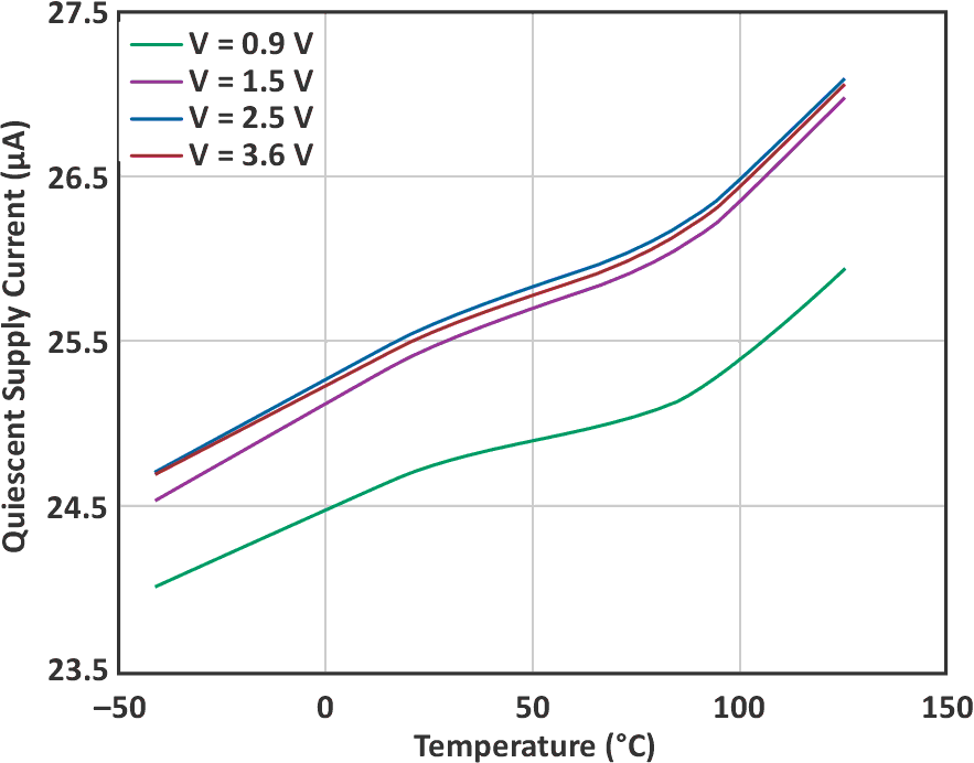

Figure 3 depicts the capture of the ethanol vapor as shown in a blue curve. The green curve is the current consumption of the entire system including the microcontroller, which is 90 mA typical. However, the current consumption of the MAX40108 itself is a mere 25.5 μA at VDD = 0.9 V and TA = 25 °C as shown in Figure 4.
Current consumption at various power supply voltages and over the operating temperature range.
Figure 4. Current consumption at various power supply voltages and over
When in idle mode, the microcontroller wakes up every 10 seconds to monitor the ethanol vapor. When the vapor is present, the microcontroller starts measuring the vapor concentration as shown in the blue curve. The red line shows the AA battery voltage at approximately 1.5 V, and the yellow line is the CE voltage.

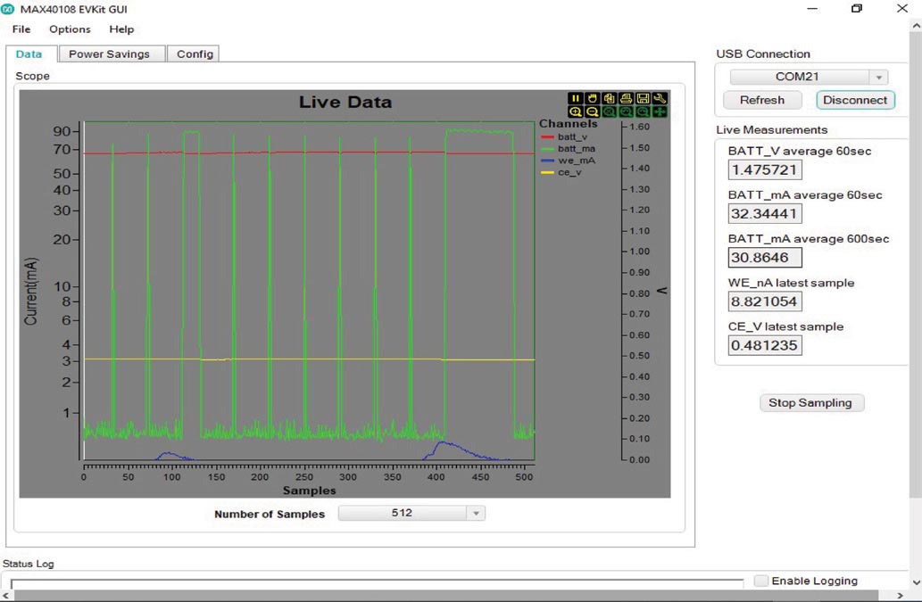

To see the effect of the ethanol sensor’s response to the vapor concentration, the cotton swab was moved farther away from the sensor. The result was captured as shown in Figure 5. As expected, the amplitude of the vapor concentration blue curve was reduced accordingly.
Performance of the ethanol sensor as vapor was moved far away from the SPEC sensor.
Figure 5. Performance of the ethanol sensor as vapor was moved far away from the SPEC sensor.

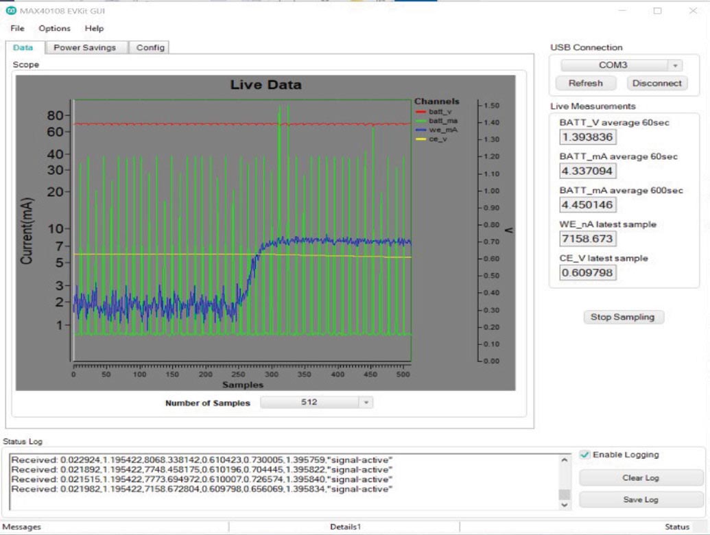

Unlike ethanol, CO is a potentially poisonous gas resulting from the incomplete combustion processes from gasoline or even a harmless candle. So, it’s important that proper ventilation be implemented to ensure health and safety when conducting this CO gas experiment. In this evaluation, a candle was used to produce the CO gas in a concealed jar, and the same sensor SPEC 3SP_Ethanol_1000 Package 110-202 was used to capture the CO gas concentration.
Figure 6 portrays the capture of the CO gas as shown in the blue curve. The green curve is the current consumption of the entire system including the microcontroller, which is typical 90 mA.
Характеристики датчика CO c микросхемой MAX40108.
Figure 6. Performance of the MAX40108 CO sensor.
As in the ethanol evaluation, when in idle mode, the microcontroller wakes up every 10 seconds to monitor the CO gas. When the gas is detected, the microcontroller starts measuring its concentration as shown in the blue curve. The red line shows the AA battery voltage of approximately 1.5 V, and the yellow line is the CE voltage.
