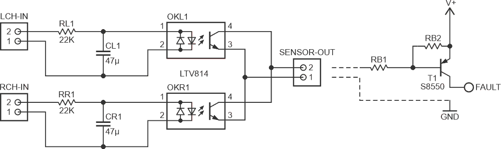

As a closing thought, here is the blueprint of a pretty simple analog front-end tailored for detecting audio offset to safeguard loudspeakers (Figure 4). I know there are similar circuits out there, but I just felt like doing my own thing.
The analog front-end is designed to detect audio offset and safeguard loudspeakers.
Figure 4. The analog front-end is designed to detect audio offset and safeguard loudspeakers.
At its core, it operated simply: When a positive or negative DC voltage appears at the output of either or both audio channels, the respective bipolar capacitor starts charging through its series resistor. Once the voltage across the capacitor hits the threshold voltage (VF = 1.2 V as specified for the depicted photocoupler), the corresponding photocoupler is triggered.
There is no reason not to use much more complex circuits. The circuit idea shown here is rather adequate for the purpose. However, note that the scheme demands suitably rated parts to work in real life. So, do not take it as gospel; make this design your own.
